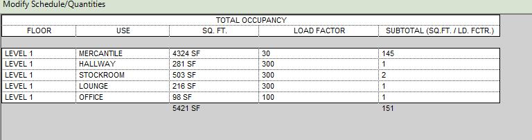

See attached image. The schedule is adding (1) to the total. The happened to any of you?
(FYI I tried seeing if there were any hidden rows, or duplicated areas, but couldnt see anything)

The total is actual data total, not your rounded values.  To get this to work, you need a new column that is whole numbers.

Thank you that worked!
