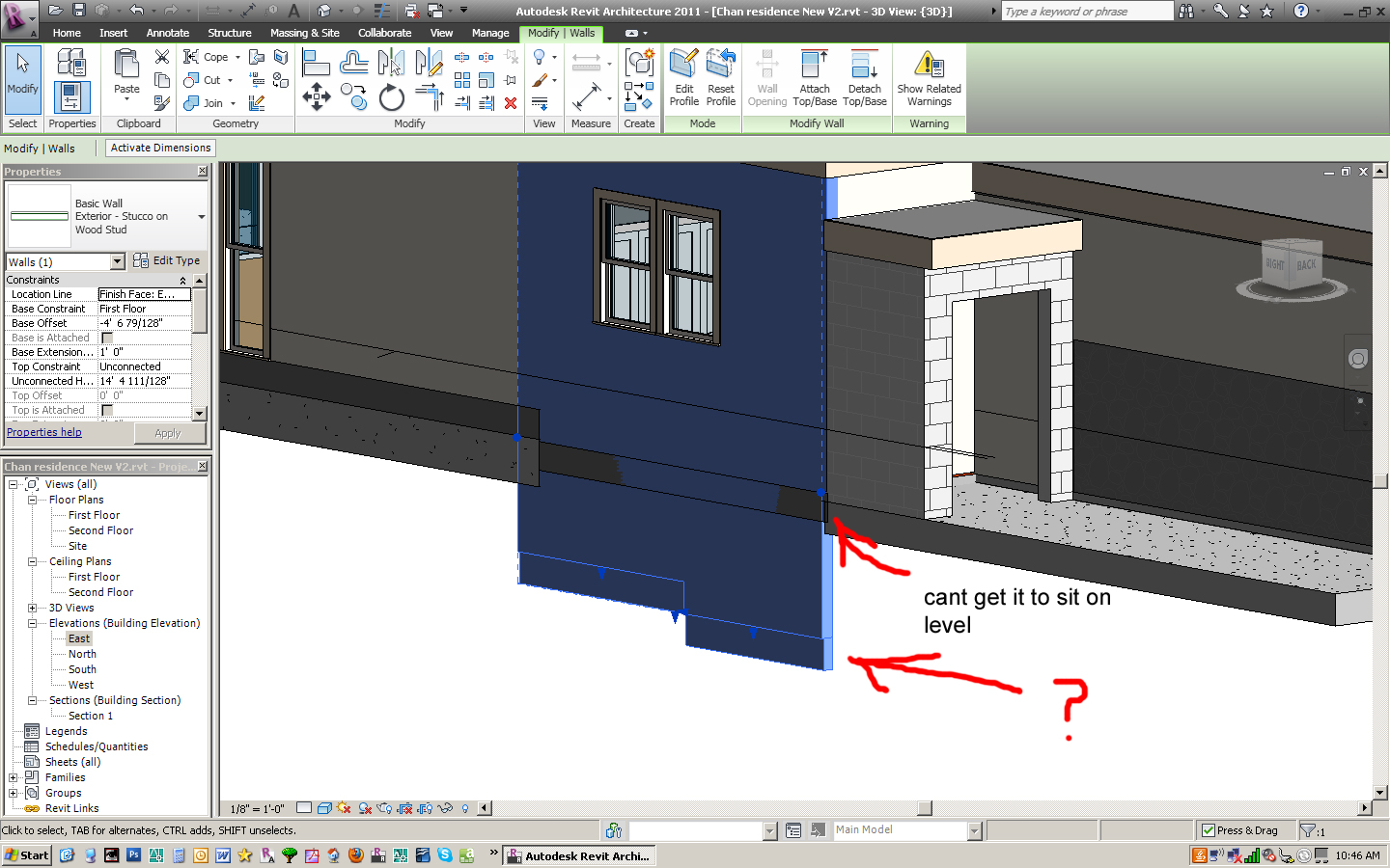

I have a basic wall. acts like a compound wall. with multiple walls incorporated.. wont let me adjust the bottom to match the floor line. even when updated in the properties.
 can anyone tell me whats going on?

Have you pulled down the layers on that in section?

Thanks, that was it. the section was unlocked and the sheating didnt come with!! good call.
