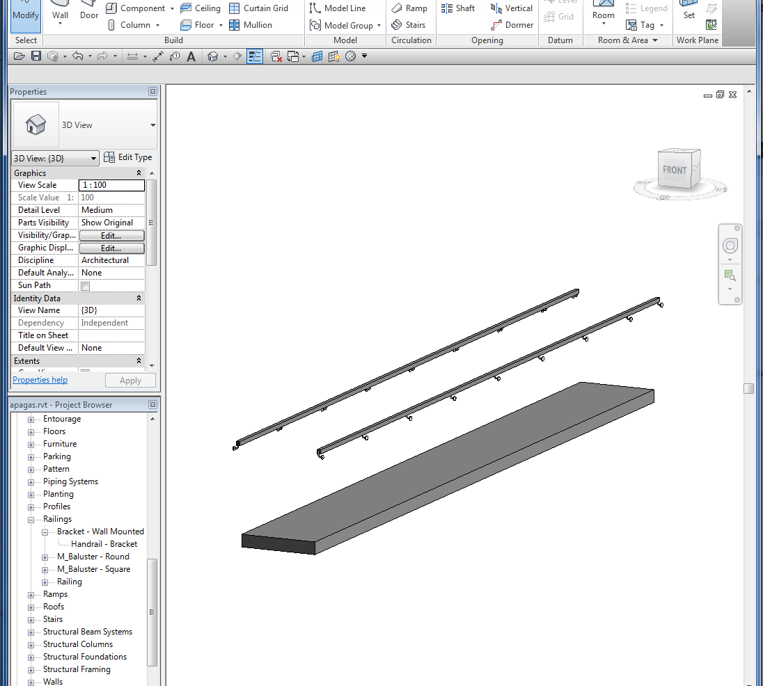

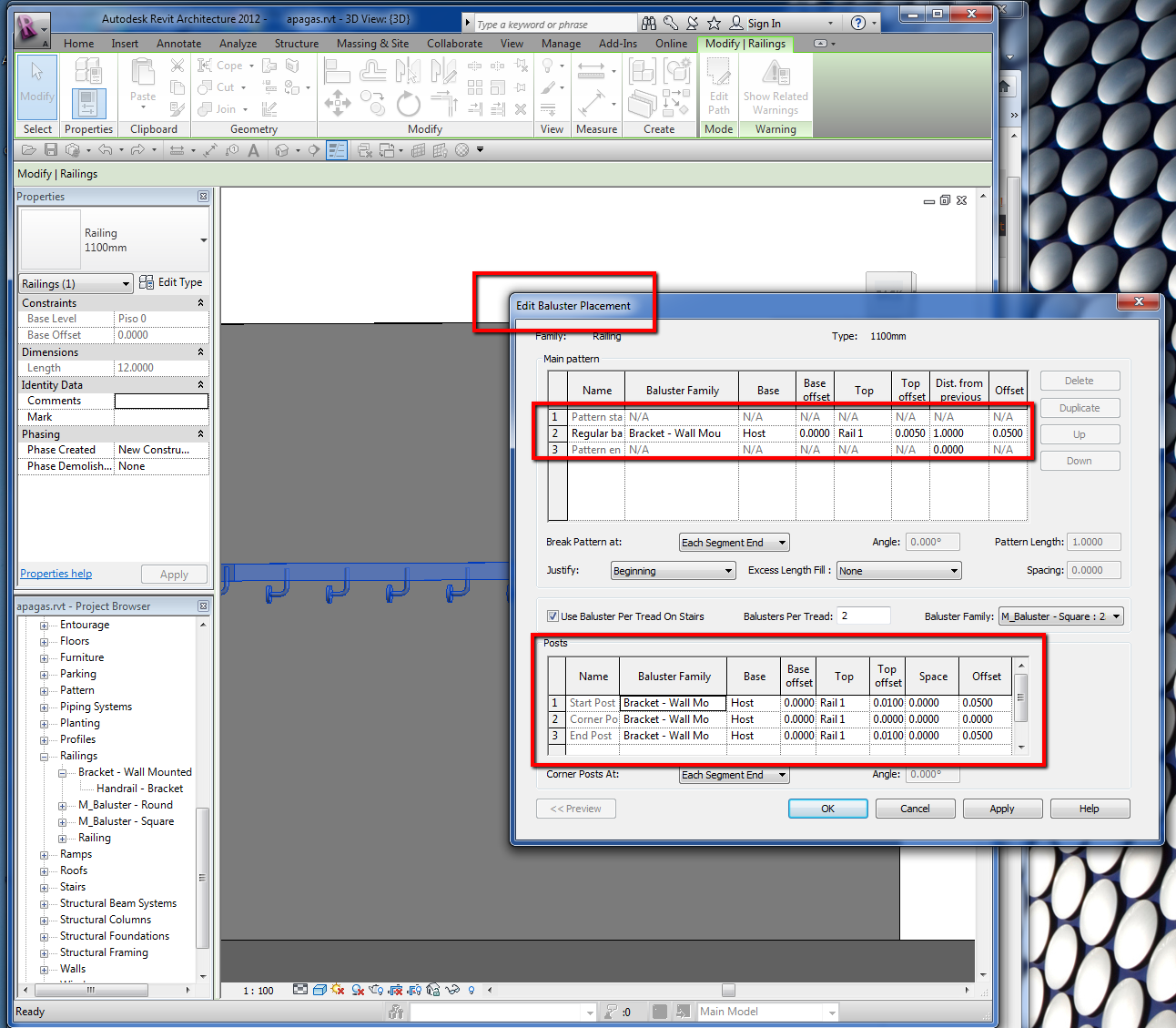

So I am extremely new to Revit and we are starting our first project in Revit. I working in 2012. I have a ramp that I am trying to create a handrail that would attach to the wall. should I use the handrail funtion. Is there a way to define a handrail without balusters? I'm not so concerned with showing the wall mounting attachement, just looking to get a rail in there that would be at the right height and rise with the ramp.
Any help would be apprciated. thanks

Use the Railing tool

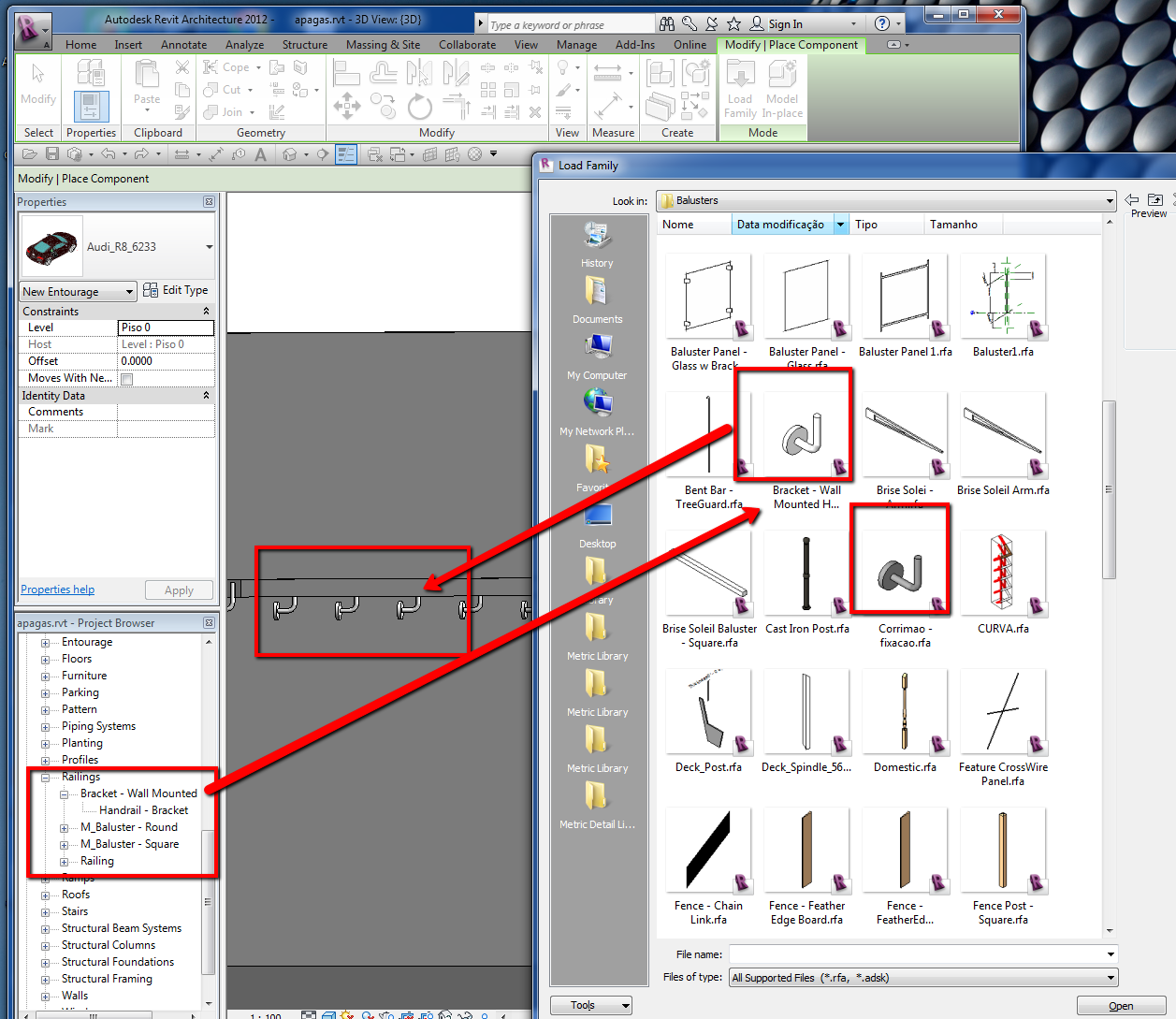

Thanks Typhoon, however I don't seem to have that option (wall mounted bracket) available in my selections. I also checked if it is within the library which I could insert and couldn'f find it. Is there somewhere that I can download it? and insert it into my library.
Thanks.
Mon, Feb 20, 2012 at 9:32:05 AM | Handrail without Balusters
That handrail bracket is available here in the downloads.  Search Handrail.
