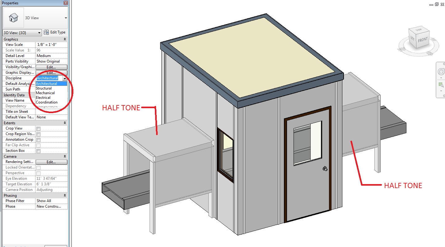

In the properties of a view, I can change the discipline of the view and that alters the way things are displayed. Can I get into these settings somewhere to alter the graphic display? I'm having an issue where a linked in model is showing up as halftone in all views and I think it may be set to this per the discipline. thanks.

have you check your visibility/graphic overrides - Revit links?

thanks for the reply, yes I confirmed the settings in Visibility Graphics and the link is not set to halftone. the VG settings are view specific so what is really throwing me off is that the links appear halftone project wide. To complete the job, I just hit the "bind link' function to bring the elements directly into the model which worked fine but I'm still curious. I must have hit a setting somewhere along the way because I've used links many times before without this issue.
