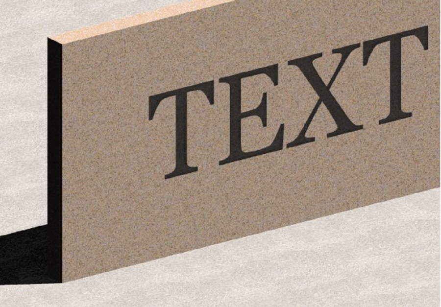

Here is one method I saw posted at AUGI. Very clean looking. http://forums.augi.com/showthread.php?t=12308&highlight=model+text Here is his example. Good Luck

thanks for the suggestion rdesign. Trouble is that I dont want to raytrace the image (ie use accurender materials). I just want to have a shaded view with shadows turned on. cheers
