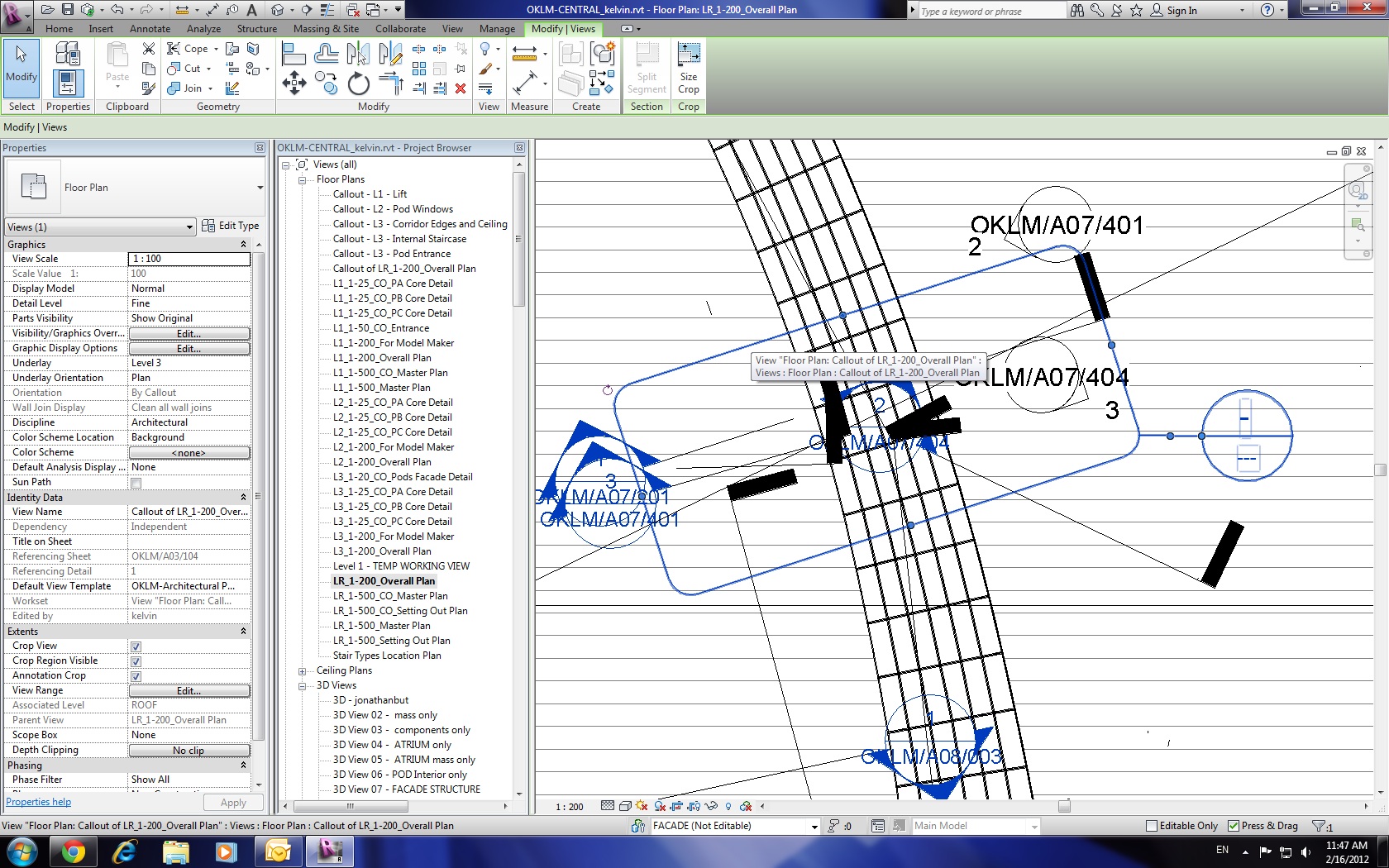

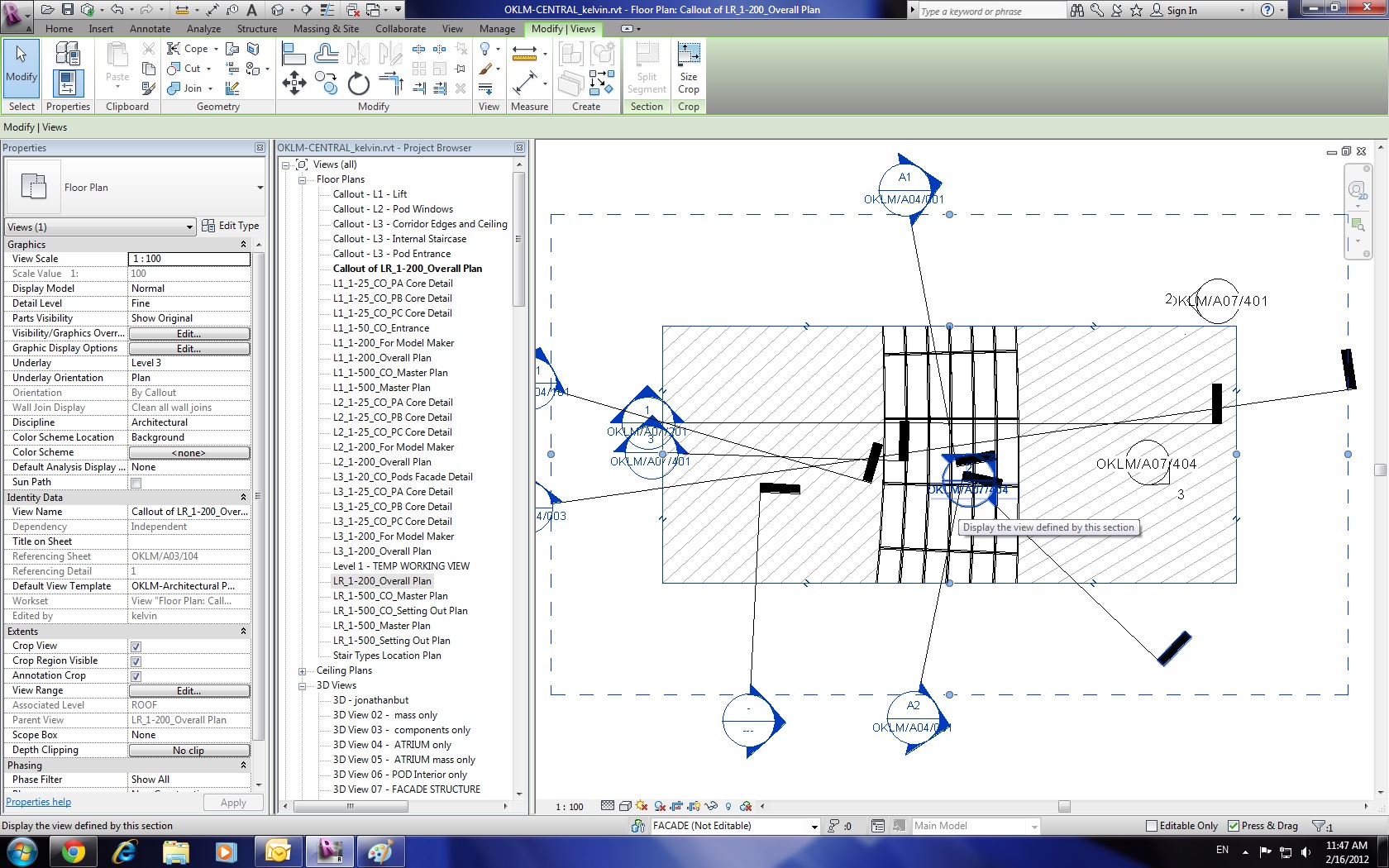

I am having problem with the hatch pattern.
The hatch pattern is basically incoherent between the PLAN VIEW and the CALL OUT PLAN VIEW. Please refer to the attachment.
How may I fix this problem? Thanks in advance.
Thu, Feb 16, 2012 at 7:20:52 AM | Fill Pattern/Hatch Pattern are not coherent in different views
Drafting (2d) patterns do not work the same as model.  It appears you have a drafting pattern there.
