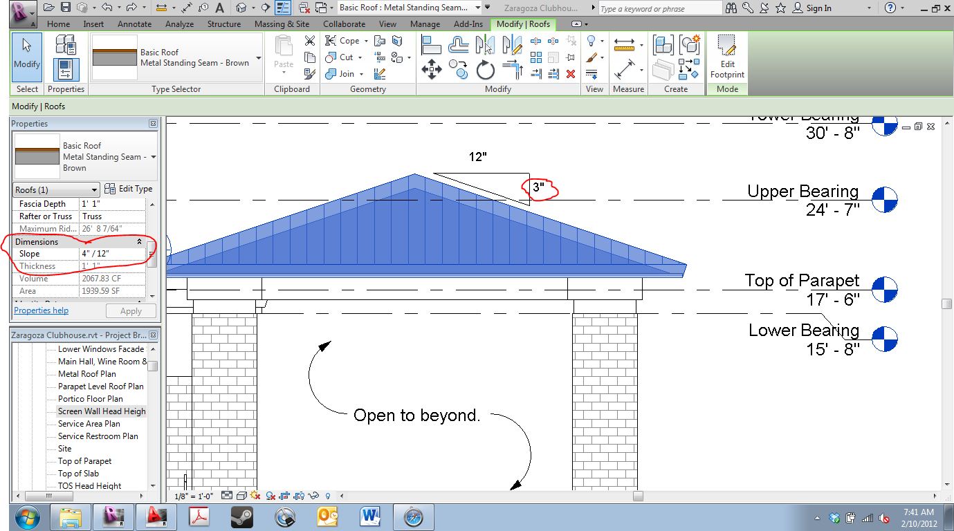

Okay, so my roof slope is at 4":12" but my slope tag shows up at 3":12" or even 2 7/8":12". See screenshot. Any ideas?
What is really odd is that if  I put the slope tag on a slope coming towards me it reads correctly at 4":12", but then that same roof in a perpendicular direction reads again at 3":12". I've also verified with model lines and dimensions that the roof is indeed 4":12"

Never mind found the solution. The tag was grabbing the hip and not the face. Tab through to grab the face.

Brilliant! Just tab though!
