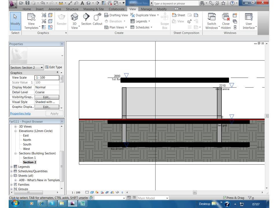

I am trying to do a basement but in section it fills wih hardcore and cant make a room space. pls can anyone help. Am obviously doing something wrong. screen shot attached. Thanks.

did you put in a pad at all to cut the toposurface?

Actually, no I didnt, Is that where the problem is?

Thanks so much mansell5. been up all nite tryin to sort that!!
