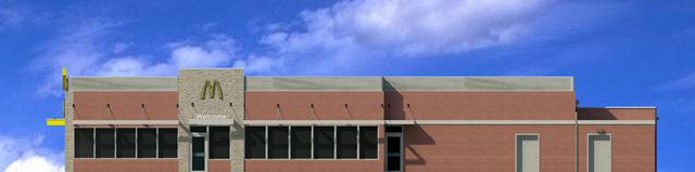

that is what I did and when it repeats the pattern. the light and dark sides repeat and don't look good.
thanks I will keep trying
Thu, Feb 2, 2012 at 3:11:17 PM | Rendering color
That is always a problem with swatches that have a big color gradient.  You may have to edit the image to get uniform color along the edges.
