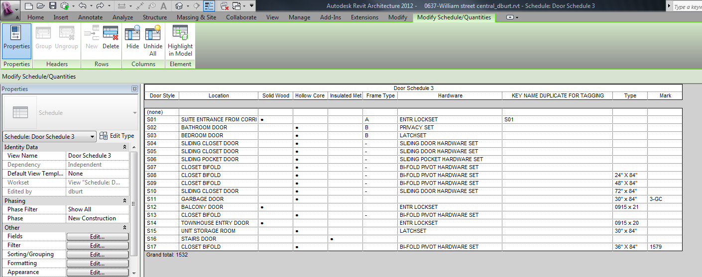

I have a condo style project. multiple units that are grouped. within each group I have walls doors windows and components. I want to generate a schedule of all the doors in a particular group or unit. the problem is when i create an instance parameter for the doors it says
Changes to groups are allowed only in group edit mode. Use the Edit Group command to change to all instances of a group type. You may use the "Ungroup" option to proceed with this change by ungrouping the changed group instances.
I also need to be able to tag this value in planview so definitly a shared instance parameter. the problem is once they are grouped you cannot do this. i made a door style scedule... problem with that is that you cannot tag the room style because it cannot be a shared parameter, nor can you bring in shared parameters.

the problem is that we need an shared instance parameter to schedule, and tag. this parameter would be the door style in the table. problem is you cannot tag a keyname so i need an instance parameter.  simple enough unless you have groups. i need to creat this value to be able to identify a single flush door for a bathroom as S03 and a single flush door for  another room as a different S0#.
I can use the mark value for this but then I loose the door number. is there a way to acomplish this without ungrouping.... see attached schedule

Don't use a key schedule as your schedule....That data will populate the data for each door and the door number can be used.

same issue in normal door schedule.

Obviously we are not communicating.
Do you understand what Schedule Keys were meant for?
In the group editor, assign each door to your appropriate "Door Style" - that will automatically populate these doors with the appropriate data from your schedule key.   Now outside the group editor, number each door as you wish using the instance Mark parameter (That is permitted).  Now schedule your doors.

Oh i understand you.... lets say your schedule key is the door style. and you want to give it a SO1 name.... try and make a tag for that..... also see the above link i posted from revit forums. aaron mailer is a great revit user and had the same issue.
