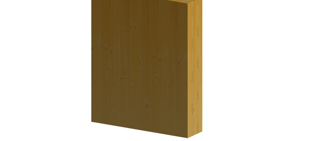

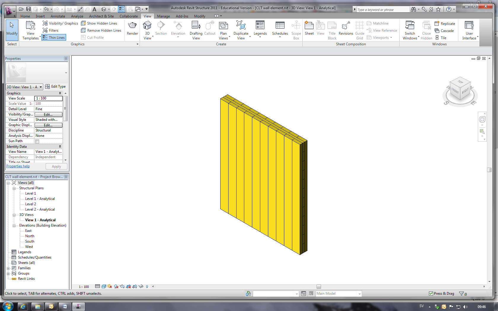

When I want to render a CLT wall element, which consists  of several layers of wooden boards, the result shows a solid wooden panel. The build-up of the panel is not possible to see, since it merges all boards to a solid panel.
What I would like to see in the render are the edges of the extrusions, so that the single boards are distinctive.
I attached two pictures: one is of the family itself and the other the rendered result.
Anyone suggestions how to render edges of the single extrusions?
Thanks!

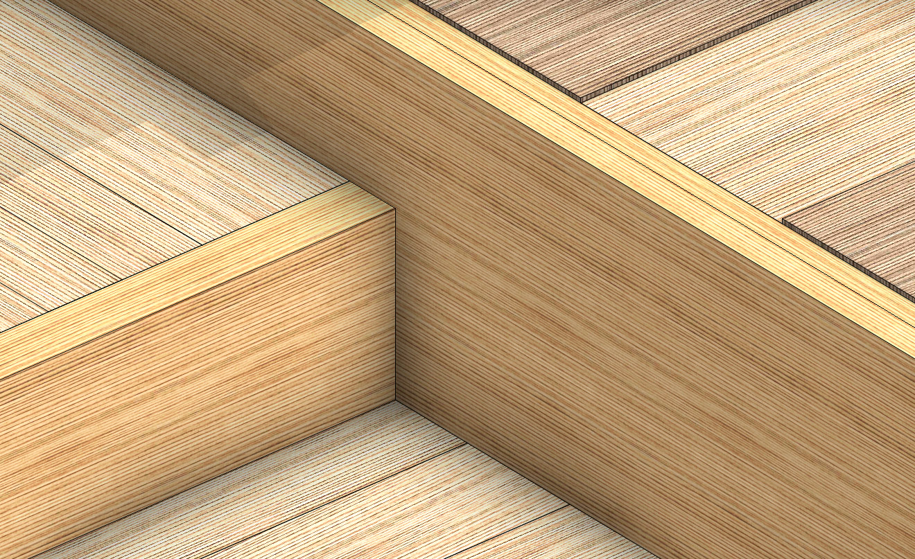

Here's a material we made out of a cedar shingle, and a scanner.  The default wood render materials are sort of... washed out, in my opinion.
If you're using revit 2012, I also think that the "realistic" view with edges enabled is far superior to an actual render, which always seems to wash things out further.  Search for threads explaining how to make custom materials, if you're interested.

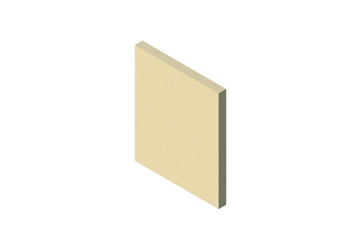

This is the result.
I modelled all boards as a single extrusion with an image as material.
Than it's just a matter of using the right scale.
Takes some patience, but it works.
