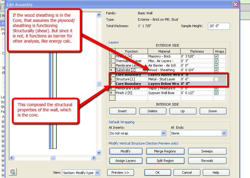

I'm not sure I'm getting your ?. Do you mean 2 or more walls atop each other? See attached for my explanation.

Thu, Jan 26, 2012 at 1:01:03 PM | Nobody's answering this one!
A clearer question would help.
"When you change the material in a wall...." <<< Meaning what?
  1. Changing the definition of a material used in a wall?
  2. Changing which material is used in a component of a wall?
"...are you changing the structure or are you changing the wall type parameters?"
  1. Changing the material definition will alter how a wall looks but it is not a change of wall type parameters.
  2. Changing a component in the wall by assigning a different material is altering the wall type properties.
