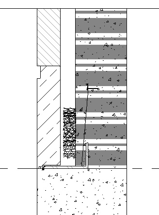

we have walls from the architect linked (and copy/monitored) into our file.  it appears they have a detail component embedded into their wall type.  How can I turn this off? Also how did they do this

here is a model of the wall.  im not sure how they did the detail.  it only shows up in section

Open their file detached and cut a section through it.  Then see if you can select this thing to identify what it is.  You can also place a copy of this wall someweher and see if the detail is still in it.
I think this is a sweep of some sort...somehow.

it is some how linked to the base sweep in the wall.  I need the base sweep however not the flashing detail

It looks like he created a detail family where he inserted the screw, angle, drainage mats, and all of the lines hat create the sweep then loaded that family into a profile family then loaded the profile into the project.  You would need to take out everything you did not want in the detail family.  I don't believe you can just shut off these items.

I have not seen a sweep use an embedded detail element that is not a closed profile. ... Learn something new every day.  I think what they have done here is bad practice ...
Your fix. ...  I would modify a family in their file.  These use families called wall base sweeps in this wall.  These have an embedded family called family 3 which has the flashing, drainage mats & termination bar detail elements in it.  You could just delete these items and relod the families or I tried setting the family 3 to shared which I then loadeded into the wall base sweeps and then loaded these into the project.  I thought I could then turn off the detail elements but low and behold ... they went away.
