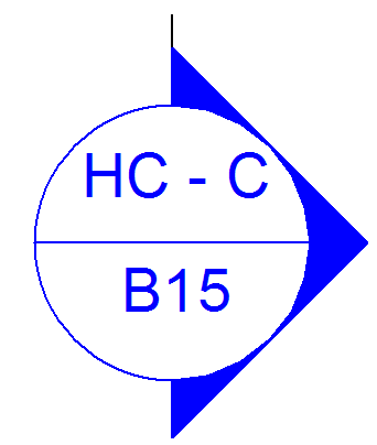

In addition, we have also noticed the loss of some of our section heads.  It's a similar problem: IE not hidden, no overrides, etc.

And by losing the section heads, I mean (refer to attached) the section head that appears on plan views indicating the name of the section and the sheet it is located on.
The box is unavailable to turn the section back on as they have "disappeared". Not sure if this might just be a glich in the program or because our file is so large.

If the section line shows and there is no circle arrow at the end of the section line when you click on it, then something is corrupted.  If there is a circle arrow - click on it multiple times to click through your head options.

There is no circle arrow like there usually is.  So with what you said about it being corrupted, would you know what might cause this?
