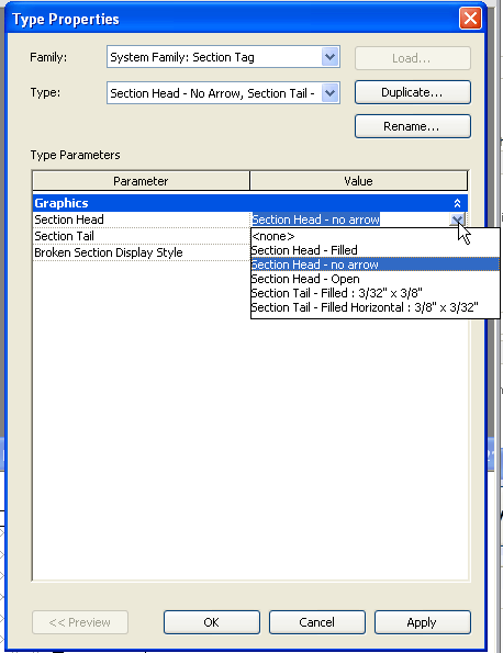

Does anyone know how to turn on the shaded area for the sections tags in your levels. I think I turn my off  by turn off sections in certain levels I created thanks.

I'm not sure what you're into. See attached.

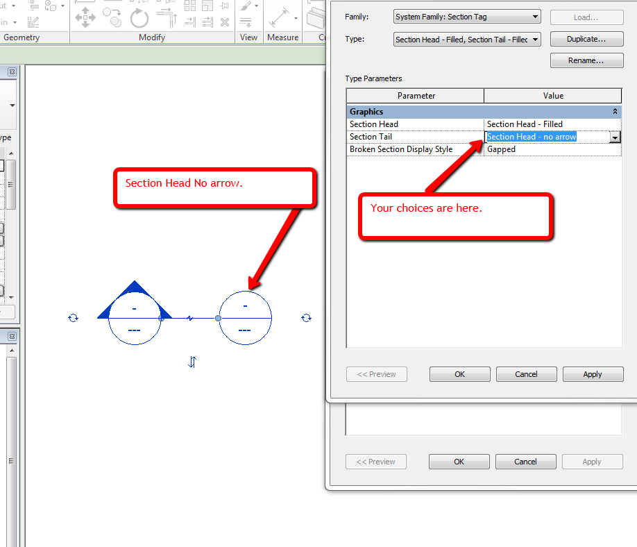

No ... His choices are possibly more like the attached image:
We use closed head for building sections and open head for wall sections.

Thanks , that was it. Some how my arrow head fill in region got turn off, but I two examples show where to turn it back on, thanks again.
