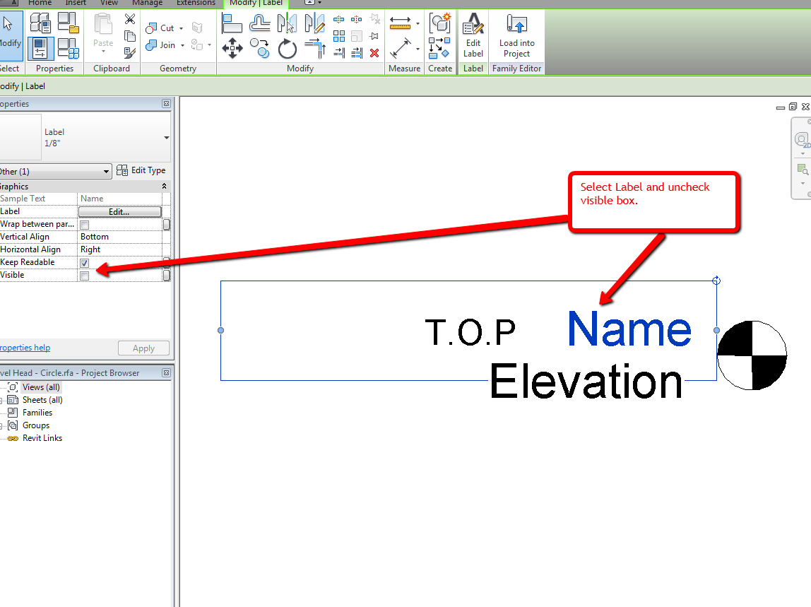

Hello all,
    I am new to revit. I have read through several books and it seems like they are great for giving you how to but when it come to real world application it falls a little short.  I am looking to call out plate heights on a multifamily building in revit 2012.  I would like the same text at each level "t.o.p." but revit won't let me have the same name. Any brillant work arounds or suggestions?  I guess I could call each level as a prefix but that seems redundant. Thanks in advance.

Edit your level family, select the Name label and uncheck the visible box. Type a text (i.e. t.o.p.), save and load to your project.

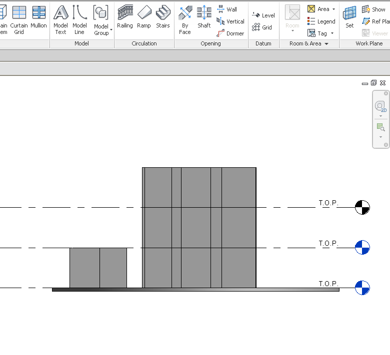

Fri, Jan 20, 2012 at 8:18:49 PM | Levels and Top of plate
mhans
Joined: Tue, Nov 7, 2006
456 Posts
3 Stars: 10 Votes
Here's what I was talking about.
Motto: "No Post left behind"
