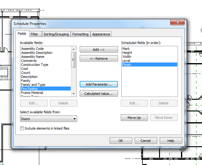

I'm learning about schedules from Eric Wing's 2010 book, but using a student version of Revit 2012.
I'm trying to enter a set of fields for a door schedule, and can see that some fields have been renamed, but I can't find the field that used to be called 'Door Hardware Group' at all. This is a pretty crucial field, so I reckon I must be missing a renamed version of that field in 2012. Anyone know what tree I shouid be barking up?
Screenshot attached but probably unnecessary.

teafoe5
teafoe5 Avatar
Joined: Fri, Nov 12, 2010
1749 Posts
4 Stars: 47 Votes
There is an "Add Parameter" option that you can use to create the hardware group field.

mylesmcnamara
mylesmcnamara Avatar
Joined: Fri, Dec 16, 2011
9 Posts
THANKS!
