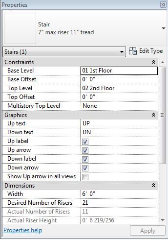

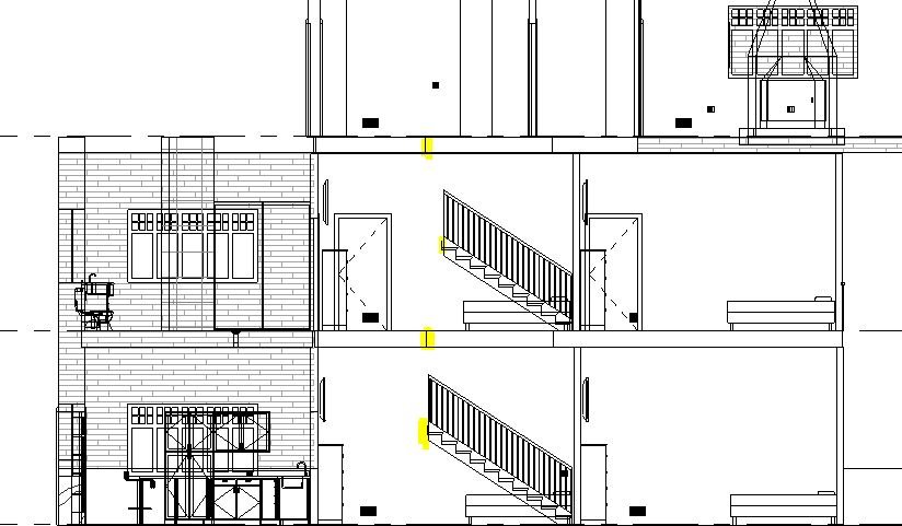

hi. im new to revit and this is my first project and about my 7th day using revit. mostly everything has came easy to me except connecting these stupid stairs. PLEASE SEE ATTACHED PICTURE

It appears that you do not have your stairs going up to the correct level.  When you are in your stair command look at your properties, under constraints there is a base constraint where you should have for example first floor and top constraint would be second level and Revit will calculate the number of treads/risers that are needed to reach that height.

theyre at the correct level..1st floor stairs: BASE 1st TOP 2nd no offset..same for 2nd floor stairs but 1 level up

1st fl stair case props

If you look in your properties photo that you last uploaded your desired number of risers is set to 21 becasue that is what revit is saying you need to reach the level with the heights you have set and your actual is only 11.  If you want your desired number to be only 11 then you need to set your riser height a lot higher than 7"

they wont let me change the actual number of risers only desired

idk if this helps but my floors are 12ft hight and the stairs is only reaching about 9ft

The actual number of risers is how many you have physically drawn in revit.  When you start to draw your stairs there will be notation on the stairs that says #risers created, #remaining and you need to use all of the remaining to reach the level that you have described.  Revit is telling you that you NEED to have 21 risers to reach a height of 12'-0" with a riser height of 7".  You simply did not drag the stairs far enough when you drew them, you only drew 11 so you needed to drag for 10 more.

I fixed my problem just by putting an 4" top off set
