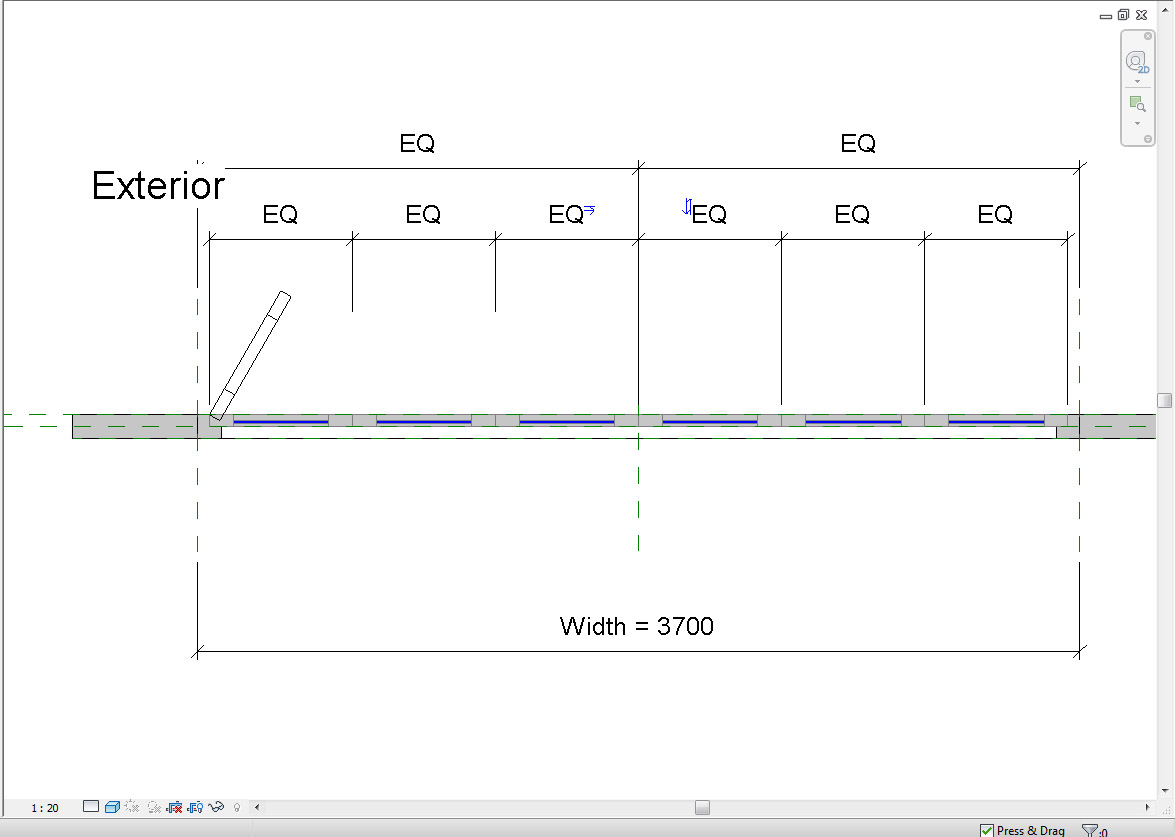

I am a newbie and i use revit building R12. I try to create Bifold family.
The model of frame and door panel i can create and is workwhen i reload to project.
But When i try to create symbolic line in plan view i dont know how to fix 45degree or any degree but not perpendicular.
Does anyone have experience in this can you sugest to me please.

If I'm correct you're trying to make familly of wich you can change the opening angle?
If so, start with a refrence line under an angle and give it an angular dimension, see if it changes as desired.
If it does draw the rest attatced to this ref line (Ref Line = no ref plane).
