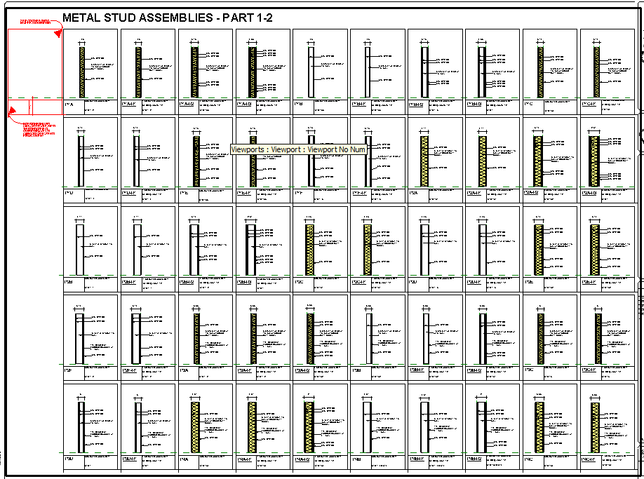

Mon, Jan 16, 2012 at 11:12:34 AM | Import Walls
Here is an image of one of our wall types sheets.
We just copy each wall type legend we need and paste it into our project.
And as you say, the rest is obvious.

So you are sayig that one creates the many walls types in a "legend" and copy pastes this legend from project to project and the "families" portion will be populated with the many wall types?
What I am trying to do is get the many wall types that are in one of our drawings to anothjer project drawing. So what I gather is that you assemble this"legend" in the project that has the many wall types with those wall types and copy/paste into the other project? Yes? and it should populate the wall family in the other project?
Mon, Jan 16, 2012 at 12:06:02 PM | Import Walls
By golly Watson, I think you've got it.
Note:  You really don't want every wall type in your template because it will really bog it down.  Our template only has a few generics and a stacked wall.  This wall types project has several "sheets".  Wood stud interior walls, metal stud interior walls, masonry walls and another sheet with a few exterior wall types.  We don't include many exterior types because those tend to be unique per project.

#9
dgcad
dgcad Avatar
Joined: Thu, Mar 17, 2005
1231 Posts
3.5 Stars: 36 Votes
Oooooo Nice Wall Legend !
So a project with a series of associated wall legends would serve us nicely.
I still cannot get a Curtain Wall to show up in a wall legend however
I have to use a work around.
