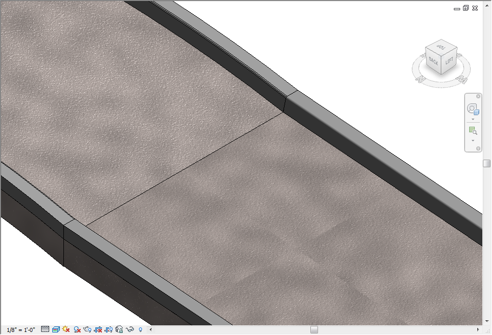

Hi! How do i create roads in/on a sloped topographie? the road should be 100mm into ground with kerbline & footpath. I can't find an offset option for a 'subregion' in 'massing & site tab'. the subregion is always on the surface of the topography.
A ' building pad' does draw the road 100mm offset into ground but I will never get the right slope of the terrain with 'slope arrow'.
Please could anyone help?

Use the floor option instead.

You need to edit the contours in your split surface to shown the new slope.  Just add enough points to create the curb and the slope to curb pavement.  Don't worry about modeling thickness of pavement/curb.  That's for details.

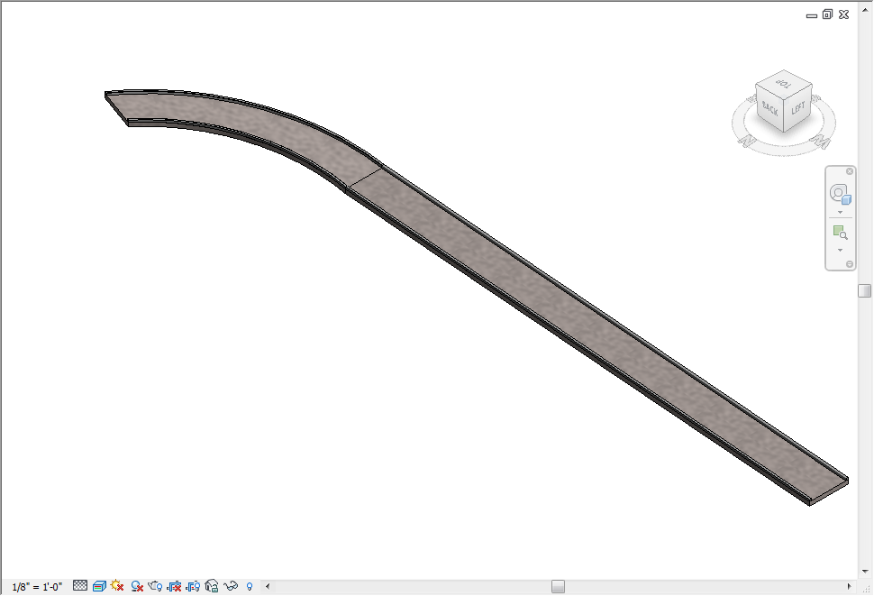

below are a couple of alternate methods, Sweep blends, and Ramp

Nice mbsteve! Floor & Slab Edge works fine, too.
