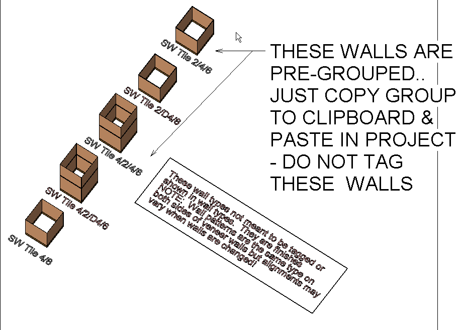

For ceramic tile walls, we do our base wall with just the substrate.  Then we add a veneer, stacked wall aligned with the face of the base wall.  This stacked wall has the base, the wainscot and the chair rail - all with the correct materials.  After you place the wall against the base, use the join tool to join this with your base.  All of the openings and wall hosted objects will then cut the tile.

BTW - We have a resource project that already has several stacked tile walls set up as groups.  Just copy paste the group into a room - ungroup / align the walls and join them - BAM - all done.

Thu, Jan 12, 2012 at 10:26:34 AM | Two Materials on a wall
You create the resource project.  We maintain several of these in our library:
  • Tile veneer walls
  • Hatch patterns
  • Doors
  • Windows
  • Toilet rooms
  • Roof elements
  • Typical Details
  • Wall Types
Each of these are set up with the various compnents shown in views on sheets by category.  Usually we show plan / elevation & 3D views so you can quickly find your objects and load them into your project.
