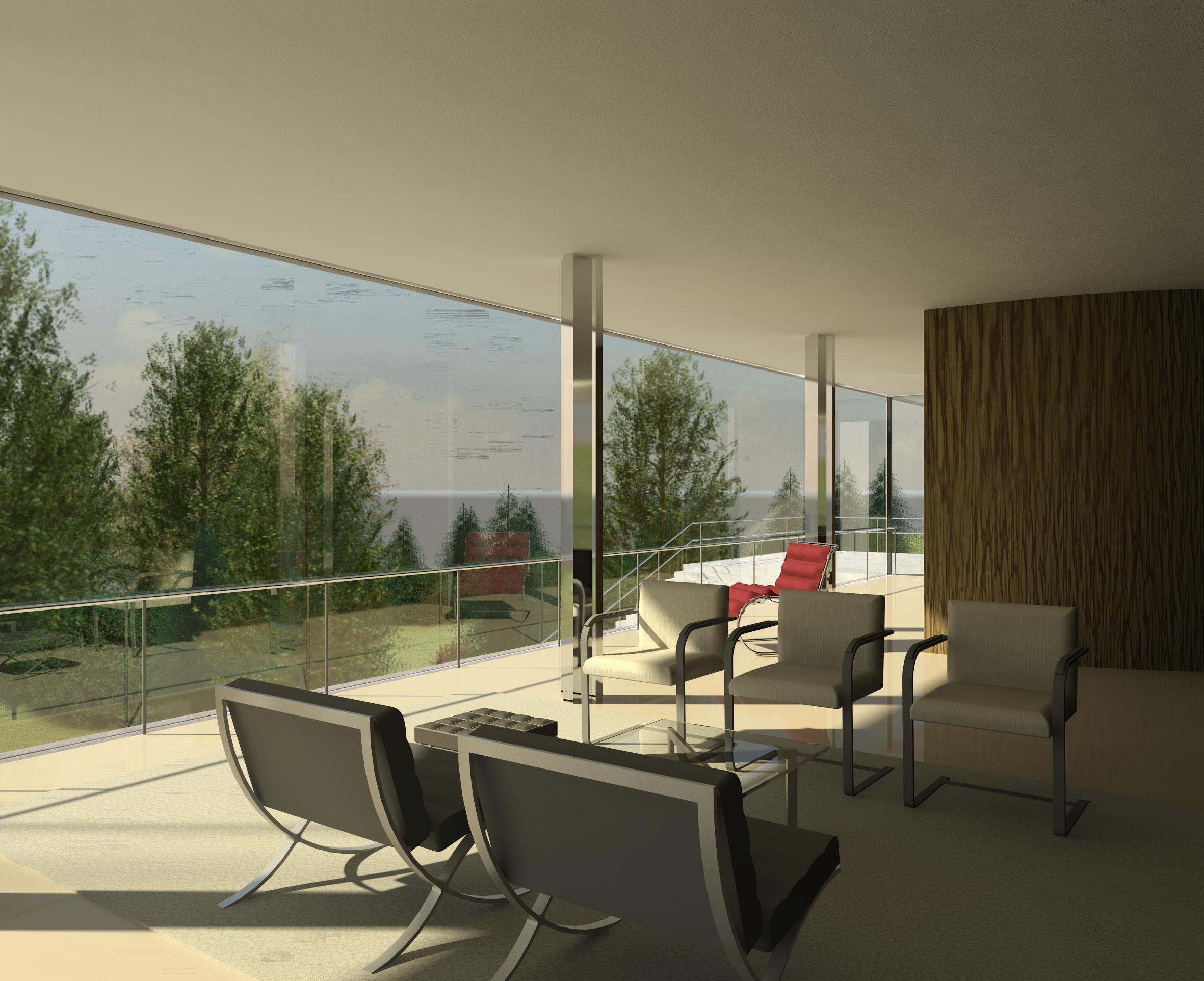

hello all, i am facing a strange problem and i would like to share it with you.
It seems that there is some king of problem on the rendering process of the windows/glasses in any progect i make(not only in this one).
its not the clouds, i removed the and still doing the same.
i also tryed to export as png in order to avoid the backround scene.
i work on a laptop Asus G74sx and its graphic card is nvidia geforce gtx 560M 3Gb (i updated the drivers and the problem is percisting)
i am adding a render i just made that shows the problem i am talking about.
has anyone ever had a problem like this? any solutions to suggest? i am thankfull for any of your suggestions
best regards to all

Are you rendering in Revit? Try attaching your background image to a solid object, like a wall. Also avoid any light source from behind your background.

I'm not sure exactly what the problem is ?
I see alot of reflection.
Can you be more specific.
The resolution could be better.

I would try doing a material override for the entire scene, hide the glass and render it. you can do this by creating a material override in the phases dialogue. if it persists is the computer, if it doesnt I would start addressing idividual materials in the scene
