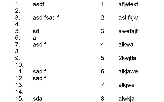

I guess I would just be getting picky if I asked for a way to auto-number lists with spaces between them...see attached picture.
What Revit does is on the left, what I want is on the right (but created manually with tabs IN the text box...)
