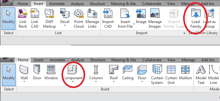

your question is kind of unclear. Sounds like maybe your trying to Import some Revit Families but you what you need to do is Load them.
Under the 'Insert' Tab. go to 'Load Family'. Then find your family.
Under the 'Home' Tab. go to 'Component' and your family should appear in the drop down.
