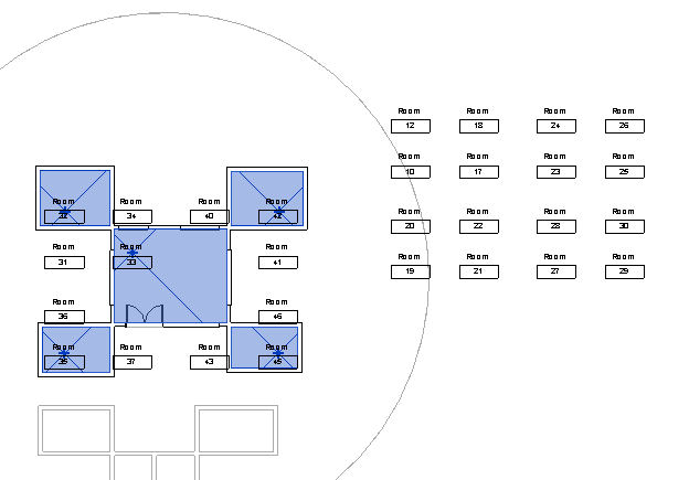

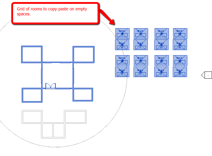

Wow, a million square feet! Is it single story? I guess you are not interested of gong in each room and defining it's properties, for now, here's your workaround.
If you haven't started putting Rooms, somewhere in your drawing area or in another file, make a grid of rooms (ex. 10x10). Make as many as you want. Select the all the room, use Filter, and copy-paste it to your actual rooms. Of course there will be duplicate of rooms depending on how smaller than 10x10 your actual rooms are. You can repeat the pasting to cover all the area. You decide on the grid and where to place them. This works also if you have a 2nd floor. You still have to go back to each room in case there are duplicates. But that said, you can easily detect that through the warnings. See screen shot.

Tue, Jan 10, 2012 at 1:25:09 PM | REVIT 2011 - CREATE MULTIPLE ROOMS AT ONE TIME
#9
mhans
Joined: Tue, Nov 7, 2006
456 Posts
3 Stars: 10 Votes
Oops! Here's the screenshot.

Tue, Jan 10, 2012 at 1:31:30 PM | REVIT 2011 - CREATE MULTIPLE ROOMS AT ONE TIME
#10
mhans
456 Posts
3 Stars: 10 Votes
Here's what you'll get after pasting.
