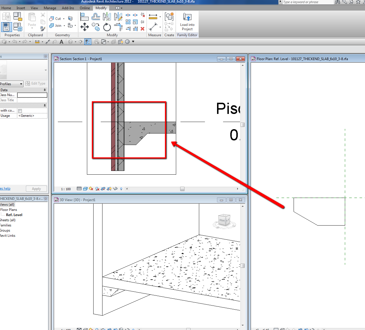

I have created a thickened slab profile which I have attached along with the floor section in my project.  When I add the thickened slab using the slab edge command for some reason it is not cutting out the line on the bottom of the floor where the floor should end and the thickened slab begins.  Its showing as 2 different pieces instead of one continuous pour.  I have done this before with no problems but for some reason I cannot get this to work.  I'm in Revit Architecture 2012.

They need to have the same material name

Thanks!
