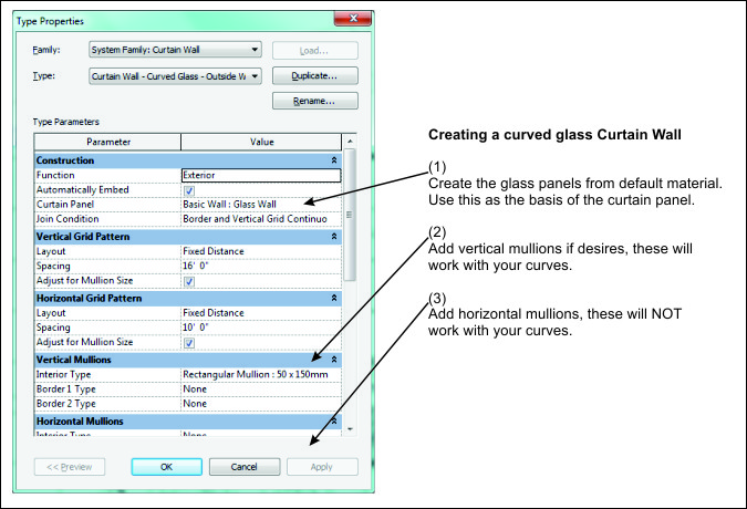

For example, I came on the issue of curved curtain walls and researched it to find a lot of people seemed to have a similar problem.  After a little fooling around I solved it by creating a generic wall and adding it to my collection of curtain walls, thus:-

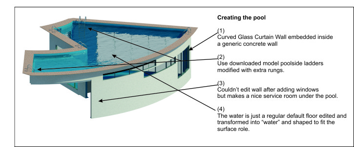

(a)  Take a generic wall, eg. concrete.
(b)  Duplicate it to create the new form - "My Curved Glass Wall" or something.
(c)  Edit its properties, replacing the concrete material with a glass layer, or double glazed multiple layers or glass and air barrier, and save it as "My Curved Glass Wall".
(d)  Create a curtain wall type, duplicating an existing one.
(e)  Make the panel material out of the "My Curved Glass Wall".
(f)  Layout the new curtain wall with its new panels - beautiful.
(g)  Ignore the fact that it cannot handle curved horizontal mullions - don't use them (or explain to everyone that they're the interior curtain rails). This worked very well for both the swimming pool and the outside walls.
If you look at the attached drawing you'll see I couldn't easily edit the pool walls around the side.  I think this is because I'd placed the windows in before trying to edit the profiles.  I might have been able to get the walls to match the pool floor after I'd reshaped it to fit the shallow and sloped sections of the floor.  Never mind, it created a nice alcove around the back for a gym.  I wasn't about to take the windows out after I'd spent so much time tugging and pushing them into the right places and shapes.

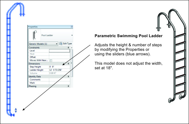

The pool ladders needed more steps, so after some study I created a parametric version with variable number of steps and height of each step.I hope you enjoy what I have produced...
MY Swimming Pool Steps/Ladder: http://www.revitcity.com/downloads.php?action=view&object_id=12016

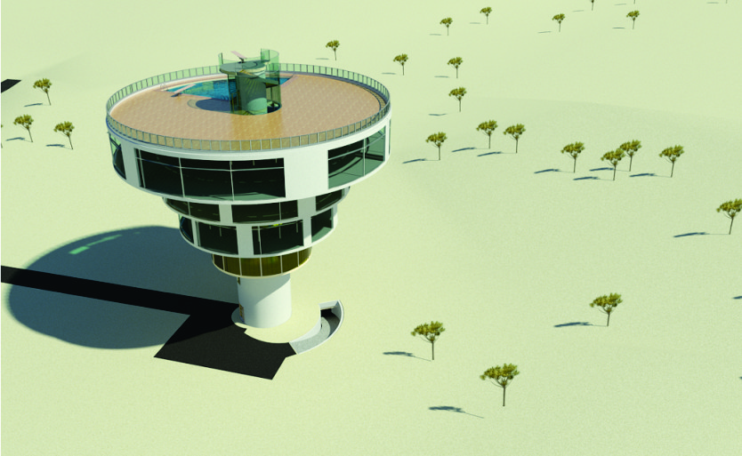

This was fun to learn and solve all the little problems.
Creating my own doodled landscapes took a couple of days then fitting them into place.  I noticed at first they sometimes appeared floating in mid air, but soon nudged them back to ground level.  Must have set them to a different level during creation.
The only problem I faced was the way a topographic surface cut through the design, the drive ramp to the underground garage appeared filled in, until I discovered the use of a pad to flatten the landscape.  After a little fiddling I got the pad, same size as the basement floor, down to the underground level, and this dragged the profile of the topography down with it!  Yipee!
To fill the hole in the topography above the pad, I created another copy of the basement floor lifted up to ground level, then edited to add a small surface coating of grass or whatever.  Similarly I added the driveway and small tarmac car park with another pice of floor on top of the ground level and aligned it to the longer driveway created on the topography.

(1)  Render the currend 3d perspective view.  But this doesn't render with sky scapes, just the generic grey ground colour, so use steeper angles to look down on the design, and put some masking hills around your design with a handy bit of topography.Found out how to set a background gradient for this later, but it doesn't render.
(2)  Set up a 3D camera view (you were paying attention to the training videos?) and line it up to render that image - with a nice background skyscape.
Interesting to see that the view, when rendered doesn't inherit the gradient background that you can set for views, and still shows whatever is the standard colour (grey) for the "ground" in the design.   Pretend it's the sea on the horizon.
There appears no way to change this background/ground plane colour, but it doesn't appear on images if you export a rendered image as a .png file - the grey becomes the transparent Alpha channel for the exported image.
Er, tried for printer quality output, but I don't have 10 terabytes of data capacity on my PC, maybe next time, or find the "gobble-your-hard-drive" option and switch it off?
