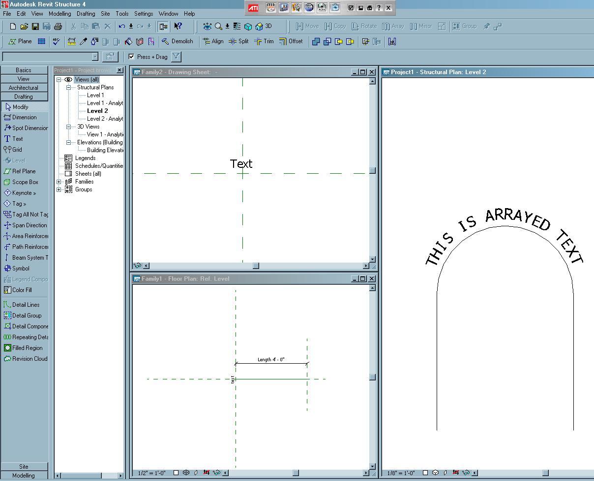

Ok after trying this myself... I would suggest creating a linebased detail component family that has a nested symbol family that contains a label for the text. I then suggest an array command in the line based detail family that utilizes a formula to array the correct number of symbols around the points center given the angle and length distance. The user would have to input the angle after placement. Then you can edit the text symbols parameters in your project to create the text. I gave it a shot and heres what i came up with...There isnt a formula associated with it yet just arrayed detail components in plan. see attachement.
Fri, Oct 6, 2006 at 12:28:20 AM | RE:
Mr Spot
Mr Spot Avatar
Joined: Mon, Jan 12, 2004
2889 Posts
4.5 Stars: 93 Votes
see attachement.
UNFORTUNATELY THIS WOULDN'T WORK FOR MODEL TEXT AS THE ACTUAL TEXT CONTENT CANNOT BE MADE A PARAMETER, JUST ITS SETTINGS
