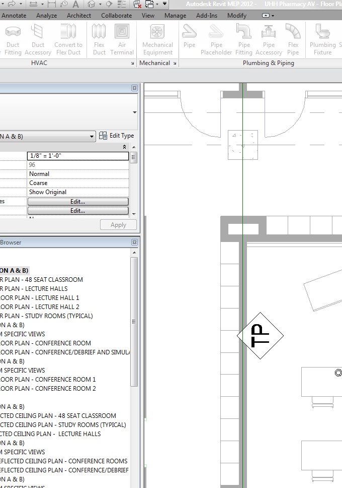

Hi,
Trying to nest an annotation symbol for wall-hosted AV control touchpanels. I understand the "keep text readable" check box will prevent the annotation symbol text from rotating upside down, however it does NOT appear to prevent text from rotating 90 degrees right or left (as shown in the attached pic) when placed on a side wall.
Is there ANY way to make text not rotate AT ALL?
We prefer not having any text rotation on our drawings.

Standrad drafting convention allows for text going clockwise from the 90 you show for 355 degrees or so to about 89 degreesand all of that is considered readable.  This is STANDARD drafting.
