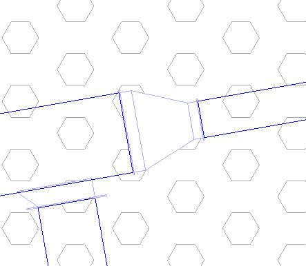

Hi guys, just wondered if any of you could help with this little question? The Ductwork in my layout is showing bold but the fittings are only showing halftone?
I have checked the VG and 'Halftone' for duct fittings does not appear to be checked? I have attached a Jpeg file
Thanks

This thread is a little old but I figured I might chime in.
The issue is with the underlay setting in the view... Change the underlay setting to none and the problem will be solved.

I am having this problem with piping.  When I change the underlay to none all my piping disappears! Can someone tell me the correct view settings for pipe/duct work layouts.  New to MEP layouts in Revit and trying to learn in our down time.
