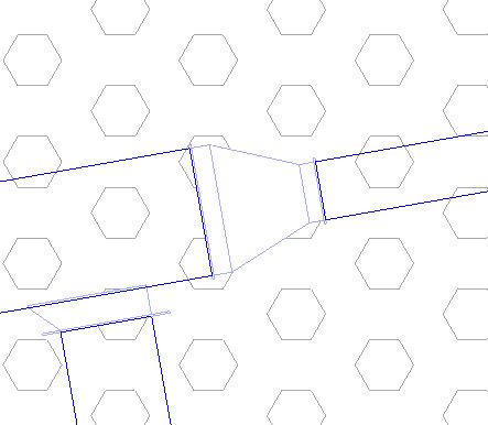

The Ductwork in my layout is showing bold but the fittings are only showing halftone?
I have checked the VG and 'Halftone' for duct fittings does not appear to be checked?
I have attached a Jpeg file
Thanks

Is there a filter above the system filter that may be working against it? Did you check the sub categories in the VG? How
about the object styles? I am going to assume the views discipline is set correctly. Is it only on your machine or is it on
others also?

Hi I ended up duplicating the view to combat this issue, it seemed to resolve the halftone problem ;-)
Thanks
