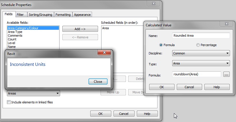

Has anybody tried the new 'roundup/rounddown' functions in revit 2012?
I can't seem to get them to work in my area schedules. I create a conditional parameter 'Rounded Area' as an area parameter based on the schedule parameter 'Area' and use the function rounddown(Area) but I always get the error inconsistent units.
See Attached.
Seems to work OK for basic numbers but not areas.
Thoughts anyone?

Try:
rounddown(Area/1'^2)
