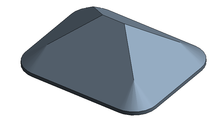

Your question could be clearer - you don't say anything about slopes but "cone" suggests you may be talking about a hipped roof.  Look at the images and I think you can figure this out.

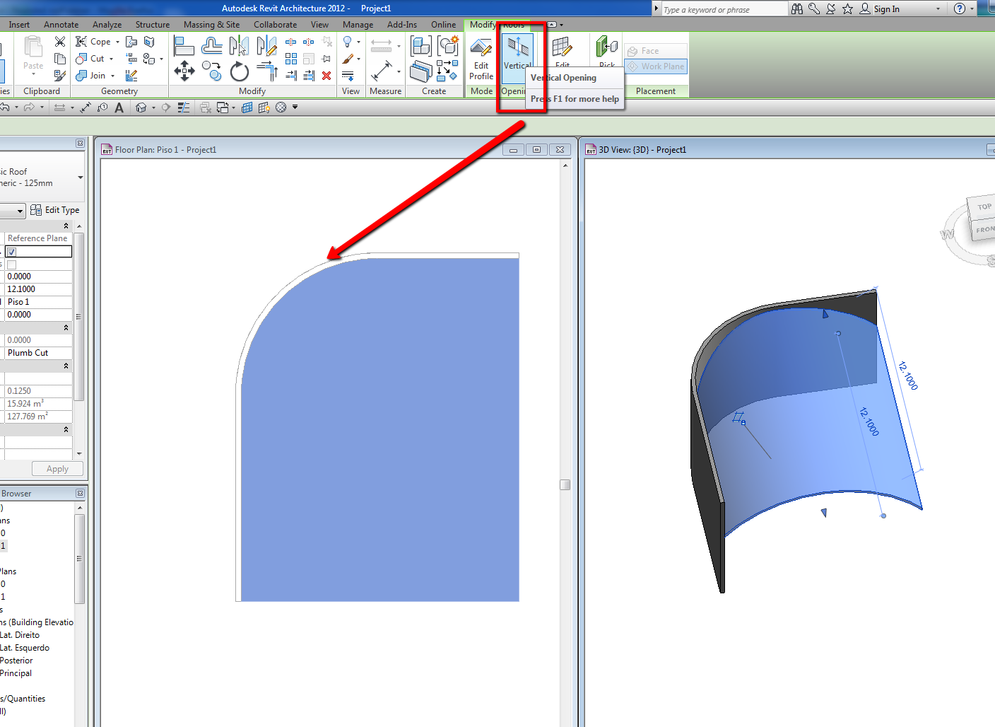

"Vertical Opening" and cut the portion you don't want to see...

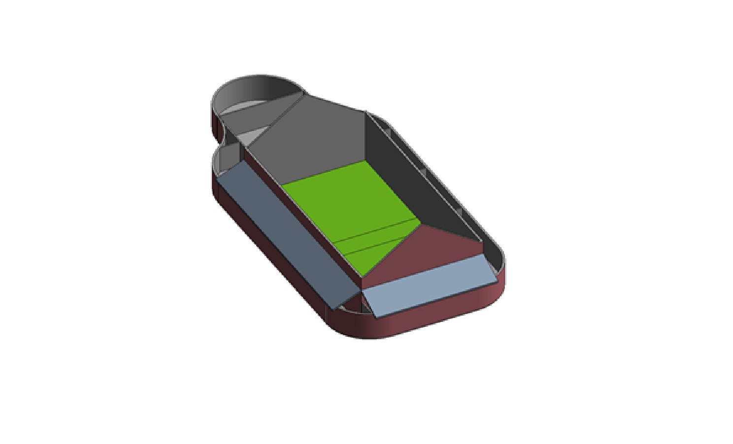

its two different extruded angular roofs coming out from a larger building in the middle, here's a photo
Thu, Dec 15, 2011 at 8:06:29 AM | Rounded roof corner
That should be one roof done like my sketch.
