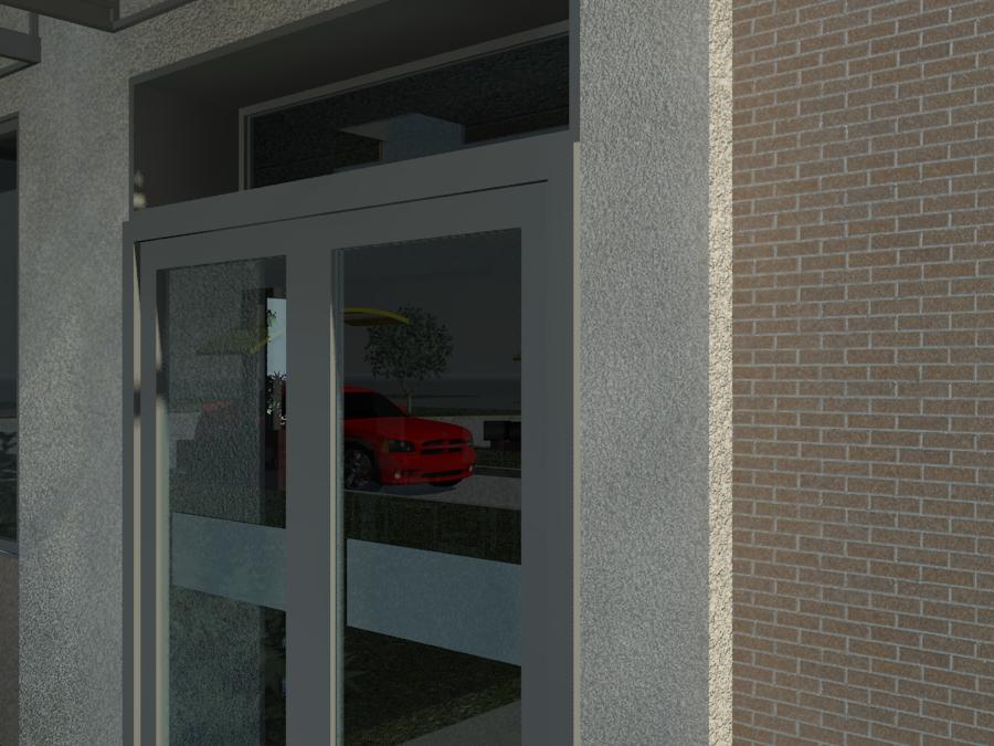

I would like to recess windows and doors back into my walls from the exterior.  How do I do that?
Mon, Dec 12, 2011 at 12:05:02 PM | how do i recess windows into a wall
What do you mean by recess?
Windows will automatically cut the wall when placed.   If you want to change where the window sits within the opening, then the family has to be built to allow for this.  Most are not built this way.
Mon, Dec 12, 2011 at 12:52:20 PM | how do i recess windows into a wall
rambo6
Joined: Thu, Mar 5, 2009
60 Posts
4 Stars: 4 Votes
yea i will need to change the family. So just change it so the panes are sent back farther? thanks
