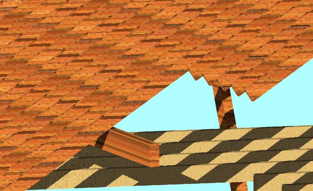

Hello, I am wondering how to add a material to a component (structural gluelam beam) that will rotate when you rotate the component. Here I what happens. Apply material to component which displays fine as long as the component is horizontal but when I rotate it to become a roof rafter the material stays horizontal. Is there anyway to make the material follow the direction of the beam? Thanks John Fleming

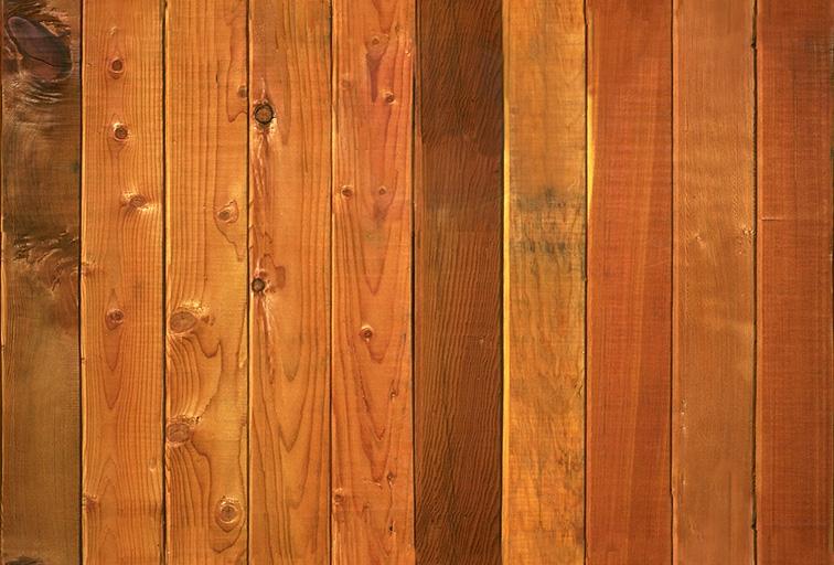

That is what I ultimitely did but it seems that you should be able to put in a accurender texture and regardless of what it is applied to should rotate with the component. It seems to be pretty complicated if I wanted to have a bunch of componenets at different roof pitches to create a texture for each one.

This is the jpeg I am using for the accurender texture.

Generally materials will align perpendicular to the plane of your extrusion/sweep solid. Not sure why your beams material is doing what they're doing, could be to do with how the beam was created/extruded/swept? Short term fix is, as suggested create a duplicate material with the jpg image rotated in accurender. Long term fix would be to recreate the beams using sweeps and voids. HTH.
