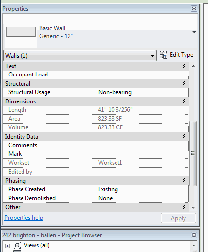

I don't have a ton of experience with creating worksets (other than basic file sharing).  If the model has already been created, is there an easy way to move each of these elements onto different worksets?  {working in Revit 2011} My coworker said I would have to copy the element - delete it - then paste again onto the correct workset - that seems like a corrupt file waiting to happen.
Wed, Dec 7, 2011 at 11:42:16 AM | Seperate Core and Shell / TI Packages in CD
Simple - Just click on the entities and change their workset in their properties.
BTW - Always look for the simple way - Revit usually works that way.  Don't overthink it.
Wed, Dec 7, 2011 at 11:52:58 AM | Seperate Core and Shell / TI Packages in CD
brooklya
Joined: Fri, Aug 3, 2007
7 Posts
The workset box in the properties window is grey.. how can I access this?
Wed, Dec 7, 2011 at 12:03:52 PM | Seperate Core and Shell / TI Packages in CD
Make the element or worset editable.
