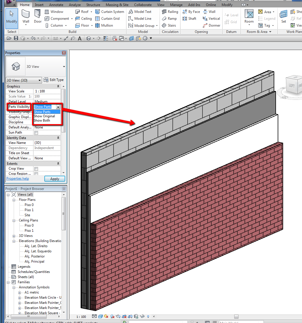

Are you talking about this?

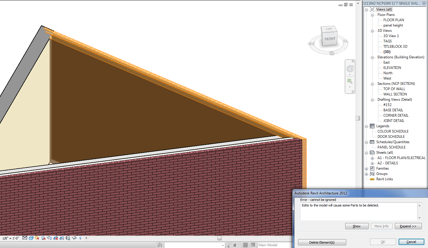

select one of your parts and hit delete...
it will then bring up this error message... hit delete element, and your wall will return to its 'assembled' state.

I got my answer at Revit-Detail Blogspot:
"Now to the schedules, you can setup a material take off, but if you select a category like 'wall' it will only give you values of the original shape(none parts modified), if you don't select a normal category and select 'parts' from the list you get realistic values coming through in your schedules."
