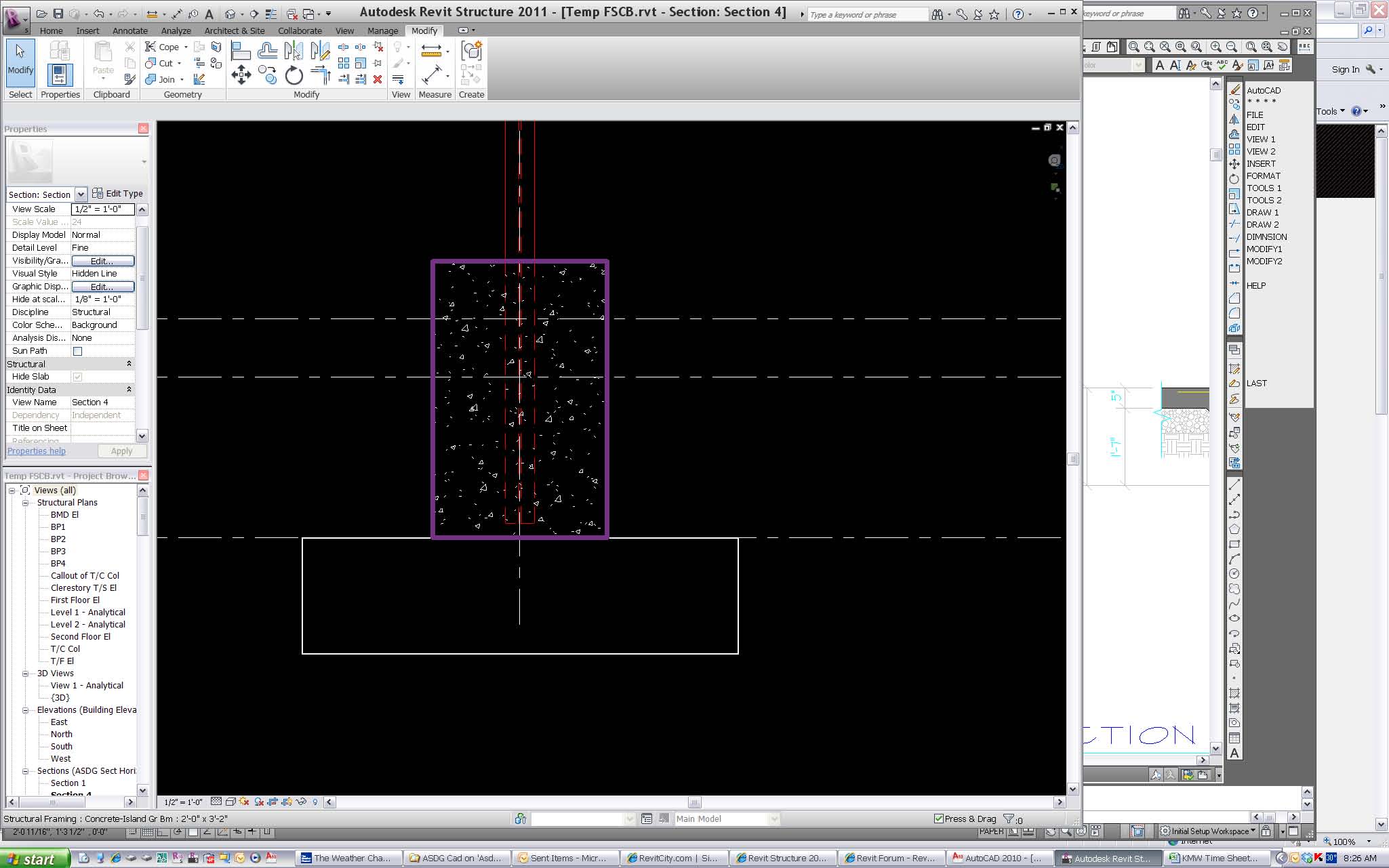

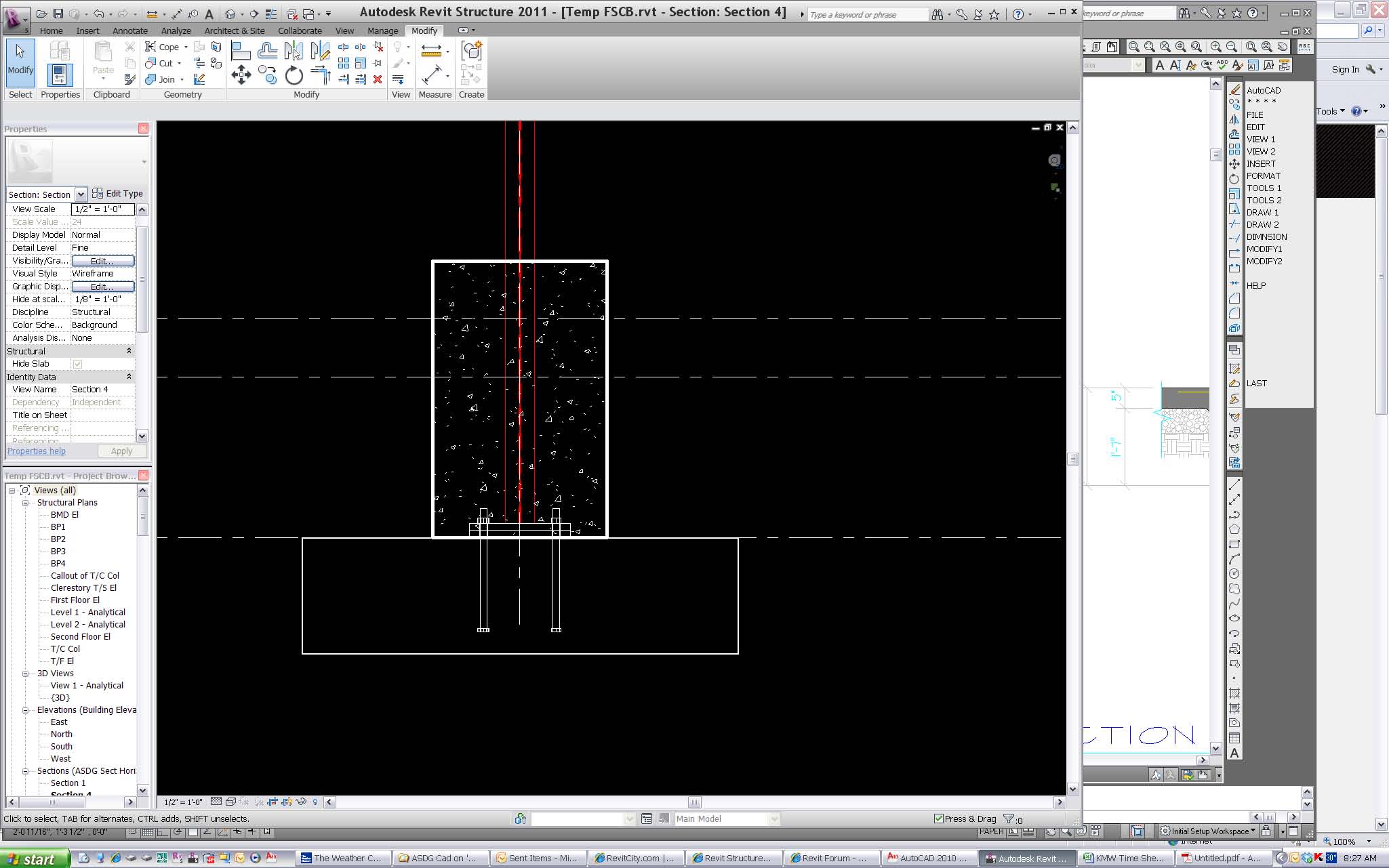

My bas plate show up in section only if I have the wireframe set, but hen my columns shows up solid.
If I have it set to hidden my column shows up right but my base plate doesn't show up at all.
How can I fix this? (The column and base plate are both beyond)

Change the column visibility to transparent by overriding the graphics for the column.
