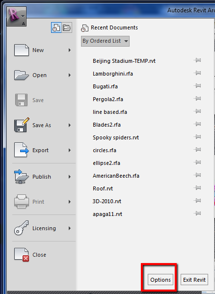

why do i have to re-upload my custom textures & decals when i want to render them? i haven't moved the project or the image. its not a big deal but tedious

Go to "Options" and Add the "path" to your Decals and textures.

how do you do that?

Big "R"> "Options" > "Rendering", here you add a new path

thanks
