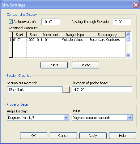

Hey guys this has been driving me nuts.. the earch hatch in my section the lines are vertical and horizontal. In Australia
we show our earth hatch on a 45º angle how can I edit this to change it.
I click on my topography and hit V V to get the visibility / graphic overides up and then go down to topography
then under Projection / Surface then Patterns I go overide. Then select the earth pattern click edit but it wont let me just
rotate it in custom. If i go to simple it will but it is just single lines then.
Revit 2018........

ohh legend. thanks heaps do I have to over ride the hatch everytime or can I make it the default earth hatch?

Fri, Nov 25, 2011 at 8:00:02 AM | Earth Hatch
Massing and site tab pull down is where you set this.
