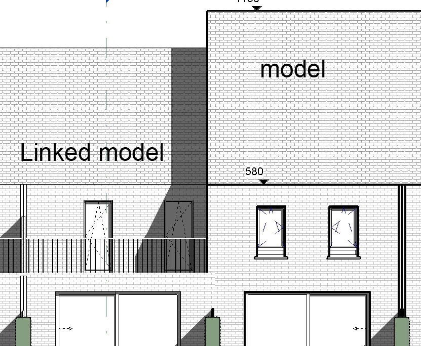

Hi,
im having touble figuring out why my lineweights dont show on my linked model,
the model is linked and set in vg as by linked view,
any ideas?

Fri, Nov 25, 2011 at 7:46:21 AM | Lineweights in linked model
Sorry but your image doesn't tell us anything and your question is unclear.
VG can control linked models.

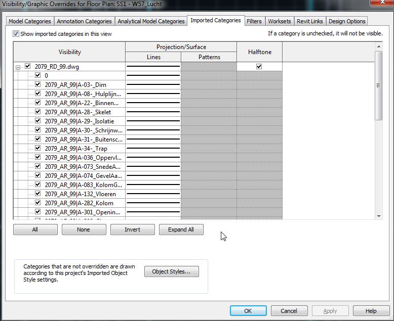

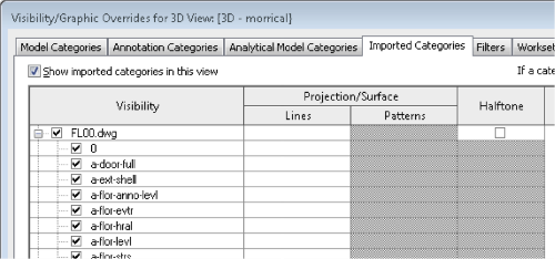

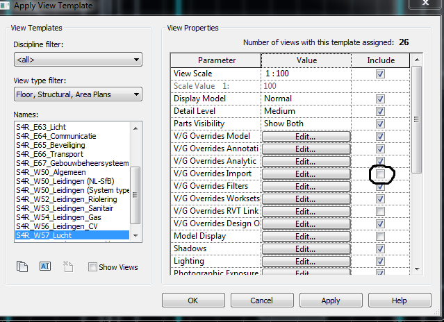

Plz follow this picture attached:
first you have to disable the view template for the import catergory.
then you control type VG command and choose the what visibility of object as you want.
hope it helps.
