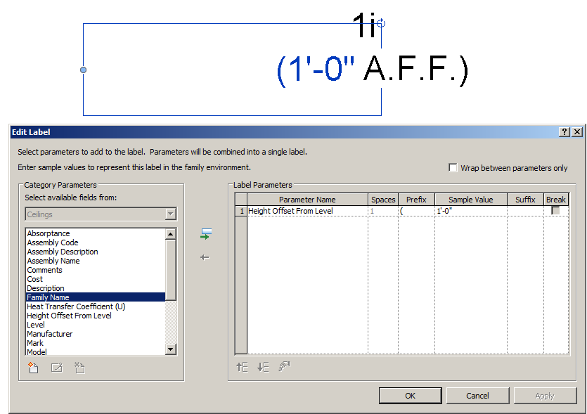

Fri, Dec 13, 2013 at 5:58:56 AM | Spot Elevation-overall height issue
The original poster never did add to the site by explaining how he/she solved the problem, that is what I complained about when he posted.
We use a ceiling tag that uses the "Height offset from level" parameter that is available for ceilings.  I don't remember if that is available in the standard ceiling tag or not but you can modify it if needed.
Edited on: Fri, Dec 13, 2013 at 6:35:25 AM

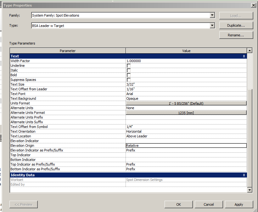

Fri, Dec 13, 2013 at 6:32:30 AM | Spot Elevation-overall height issue
Forgot to add - if you want to use a spot elevation tag in a section or elevation view, you can modift that tag creating a new type that is relative to the hosted level.  See image

Hello, I have found this thread and thanks for these solutions. But if I want to show the ceiling height (I mean the distance between finished floors and finished ceilings, not the ceiling level) on floor plan, how to do? For ex, in some places, the floor is 200mm higher and the ceiling is 3200mm higher than the current level, that means the ceiling height must be 3000mm, but when I use spot elevation tag (relative type), it always shows 3200mm. I can create another level but it is not convenient since I have a lot of different floor levels. Is there any better solution for this issue? Thank you in advance.
Sun, Mar 6, 2016 at 2:19:52 PM | Spot Elevation-overall height issue
#10
As I wrote earlier, you can use a ceiling tag to show the height above floor.   Make sure the ceiling is set to the correct level and ...yes... if you floor level steps, you should have a level for each.   That doesn't mean a plan for each and you don't even need to see the level except where you want to.
