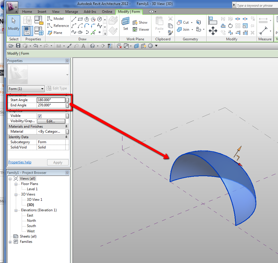

This is what I did:1) Went into  Mass Family (to start a new mass)2) created a sphere3) created a rectangular cube that covers the bottom 2/3 of the sphere (so that you see only the top 1/3 of the sphere popping out of the top cube face)Goal:  To cut the sphere so that I am left ONLY with the top 1/3 sphere, i.e. the rectangular cube is gone (and took away the bottom 2/3 of the sphere with it).I have tried the Cut Geometry function but doesn't seem to work. Or I'm doing something wrong. Please help.Many thanksDeeply appreciated.
Mon, Nov 21, 2011 at 1:42:49 PM | Can't Cut It!!!
Yes, what you are doing wrong is your not thinking Revit.
First - do you really want a mass?  I build with walls - roof - floors.  Revit does too and in most cases, you should think that way so mass is not the first thing to think of.
Second - just use a revolve that is part of an arc.  No need to cut geometry.

Just a question: did you know you have parameters to create your sphere like you want and don't need to CUT that with a void?
