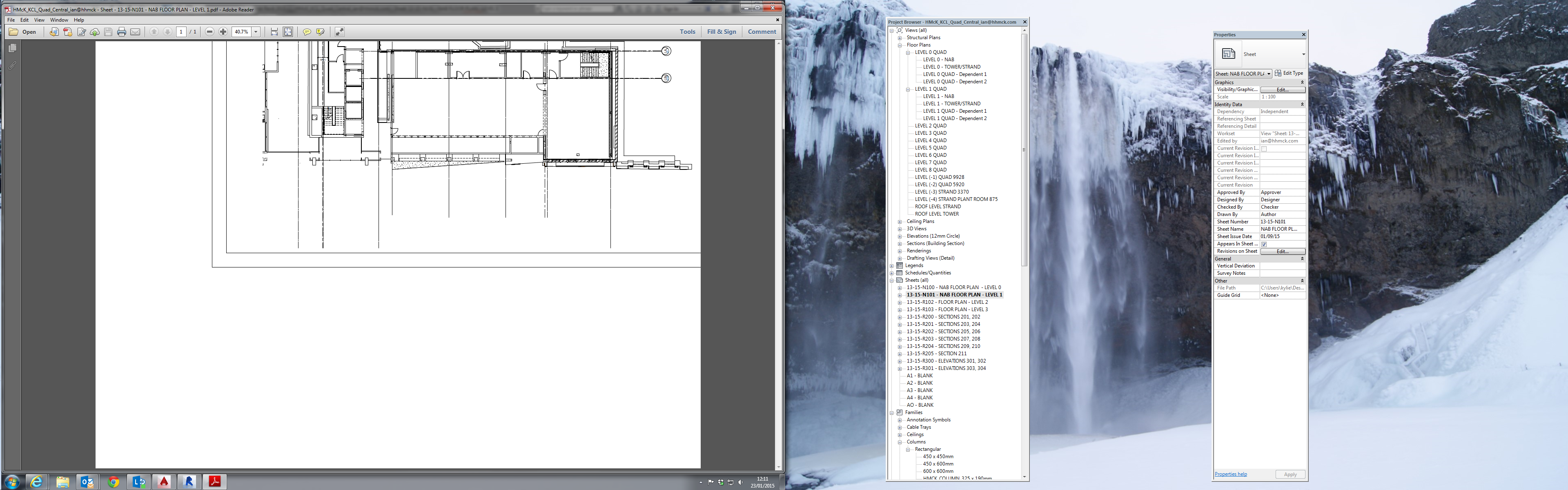

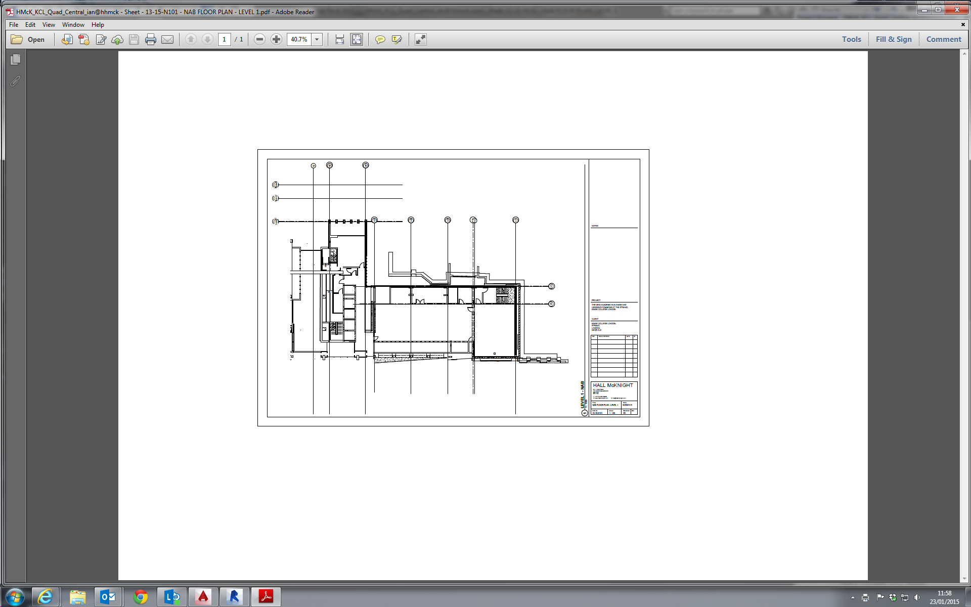

I am encountering the same problem. I changed fit to page to zoom 100% paper size and print setup is a1 and sheet template is a1.
what am i doing wrong?

when i print zoom 100% instead of fit i get a cropped view.
i have tried my sheet templates on another revit file and it worked perfectly so i know its not the sheet template

worked it out Smile
i had loaded a sheet template with parameters ranging from a3-a0. it was picking up the a0 size even though the a1 family was being used. i have now deleted the sheet template and im soley using a titlebock with sheet dimensions and borders included. a3-a0 made separelt and not with parameters for differing sizes.
i hope this helps if anyone else has same difficulty.
