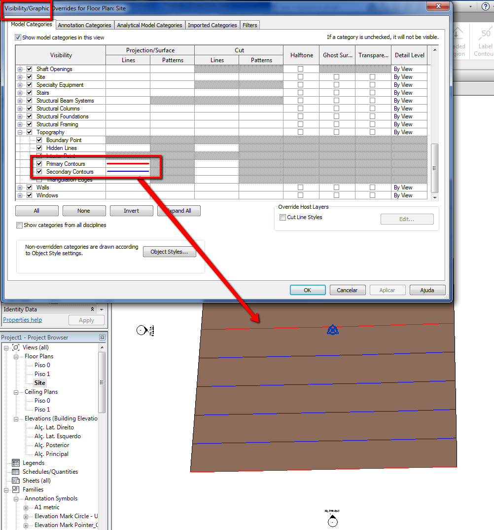

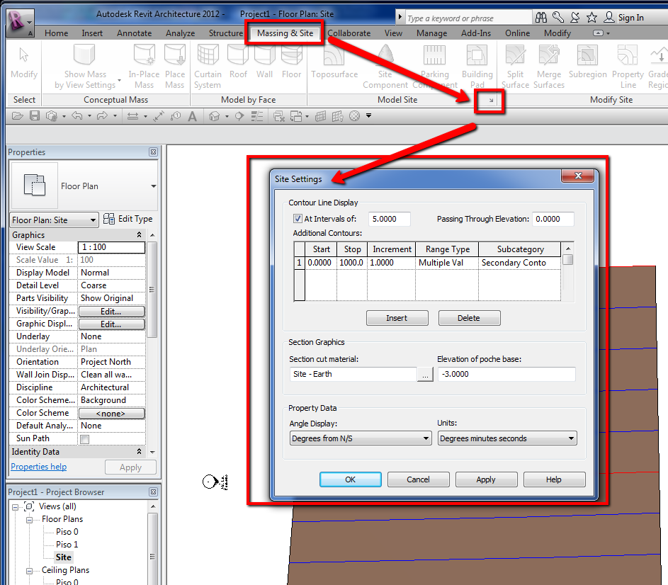

I forgot to ask what Revit version you use but take a look at these images

They also have to be turned on in VG.

Look again at the image Typhoon posted - your answer is there.
