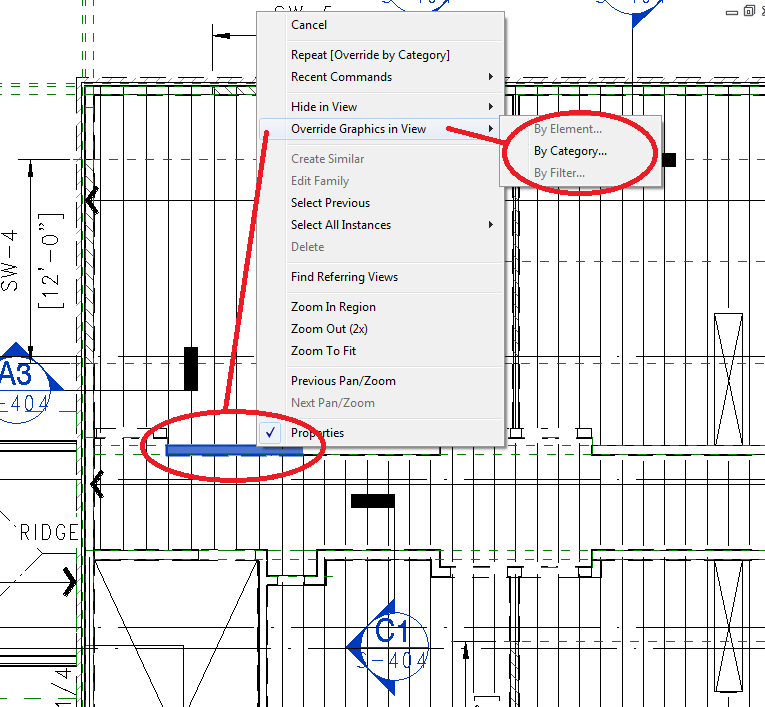

I can tab-select to grab one of the walls, but only can only Override Graphics in View by Category (see screenshot).  Is this what you mean?
Mon, Nov 21, 2011 at 8:22:18 AM | What should the Revit Structure Cut Plane Depth be set to on framing sheets?
Oops, your right.  I guess I had forgotten that you can hide individually but not over-ride...... Sorry for the miss-direction.
