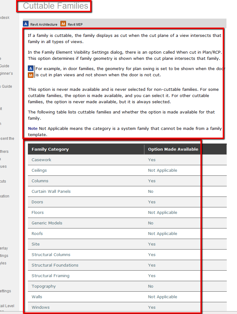

Maybe this can help

oh yes, that does help.  thank you.

just wanted to update...  I inserted the acad model into a cutteble family (casework) and it cuts fine in sections now.
but it still does not look right in the plan view.  all the settings seem to be correct.  this one baffles me.
thoughts?
