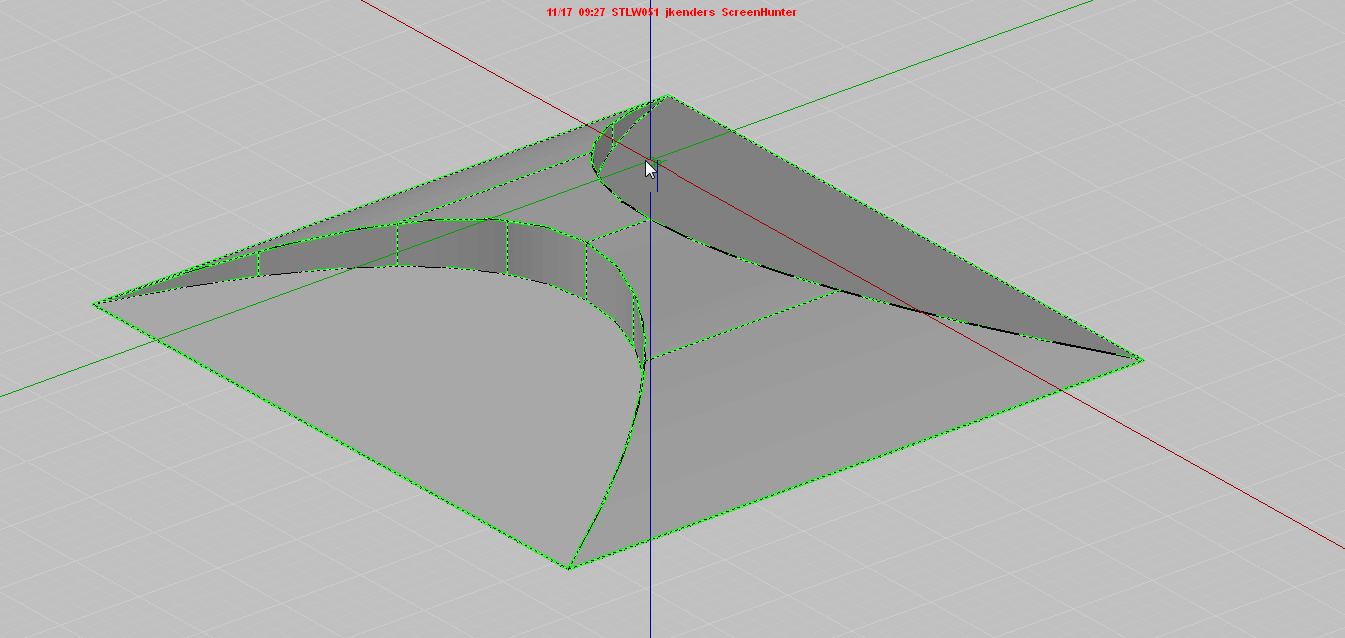

how do i post a screen shot, i tried a JPEG and its not showing up

Thu, Nov 17, 2011 at 9:29:01 AM | Converting AutoCAD 3d Solid in to a Revit Roof
EndersJKE
Joined: Fri, Oct 16, 2009
4 Posts

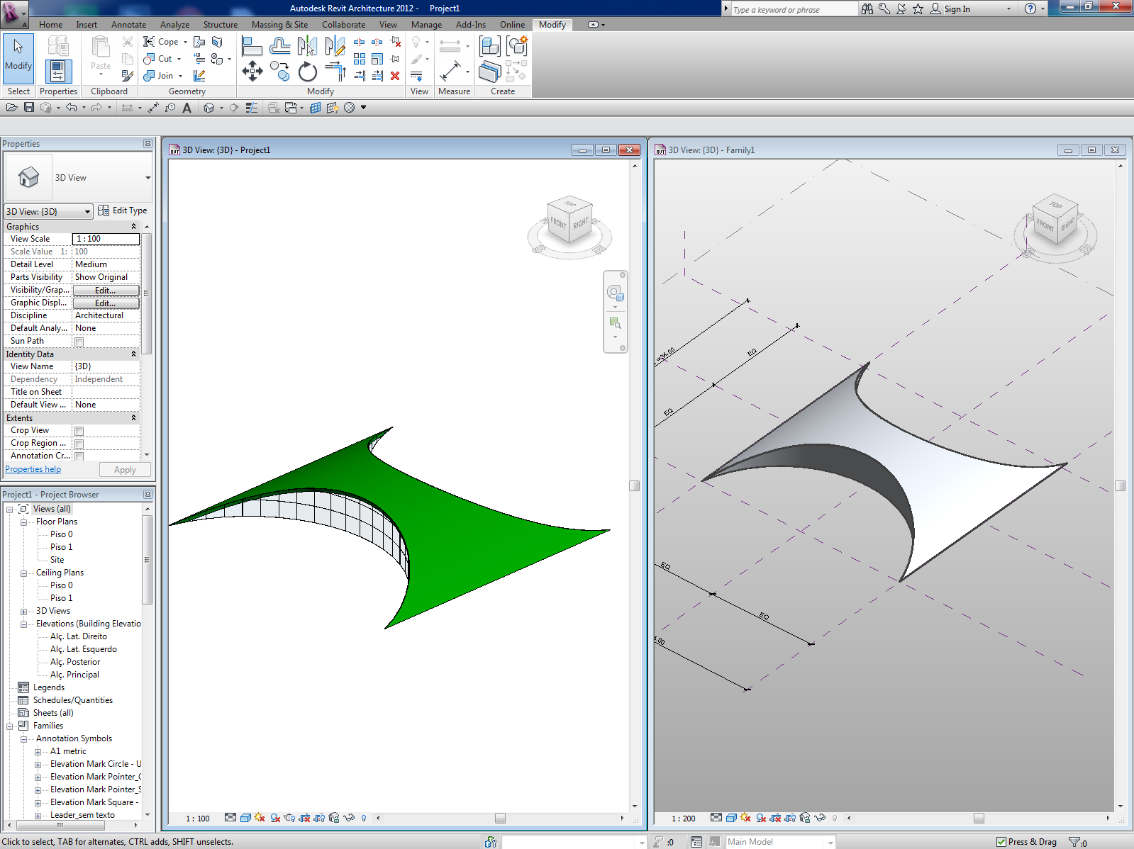

Like I told you before at the chat room, apply roof by face and wall/curtain system by face
Hope this Help

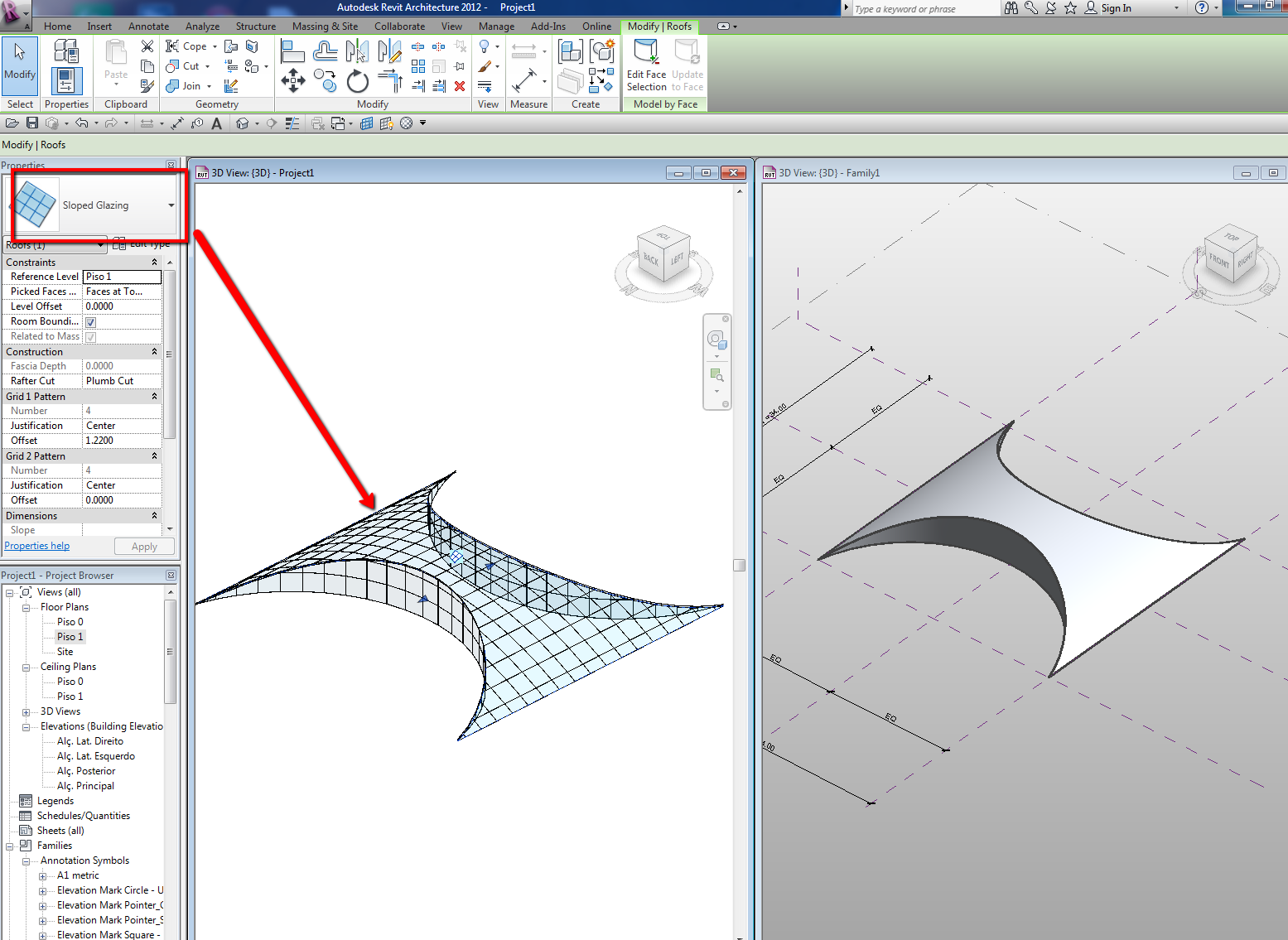

Or like this
