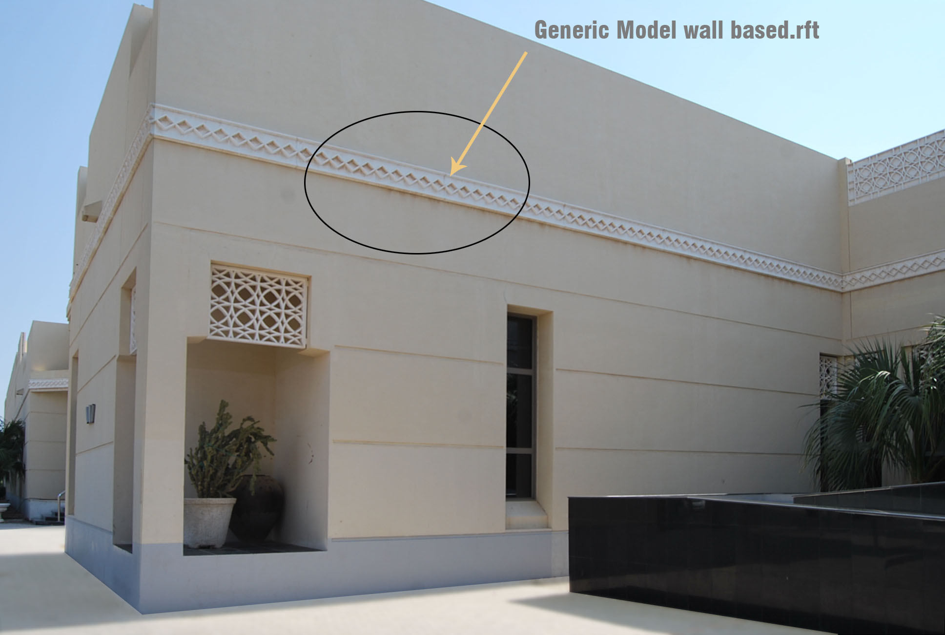

 Hello everybody,
My question is how to insert wall based element (like the attached photo) into wall to be directly placed on the wall when we create a wall?
I know that we can easily  attach a profile to the wall at a certain height by using wall reveals command (inside wall structure) but is there a way to do the same with an element like the element in the attached photo?

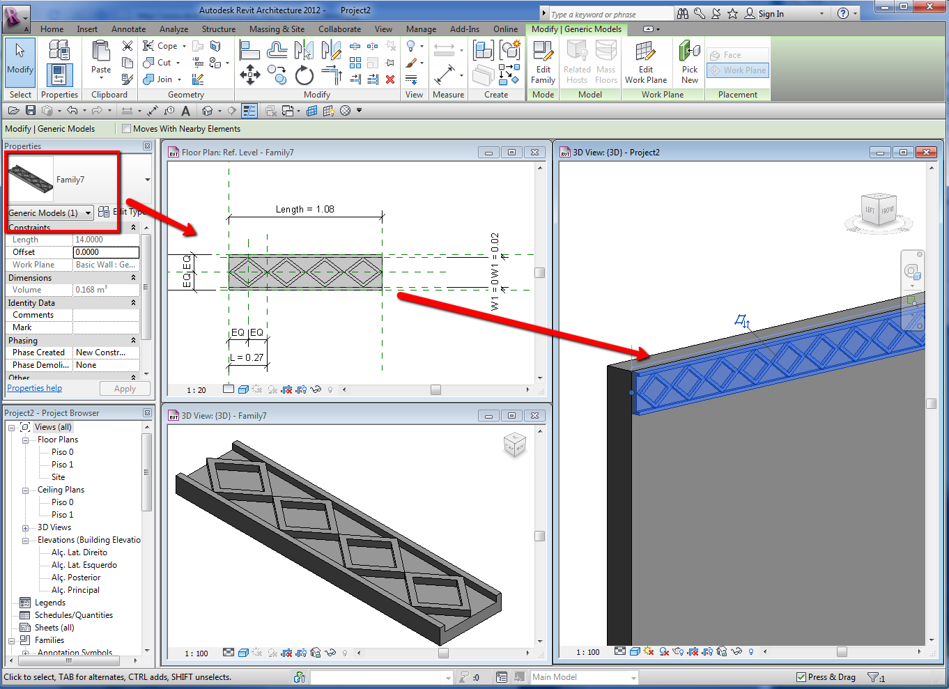

Create a "Generic Model Line based" then place that in an elevation view.

I tried "Generic Model Line based", it is really great, thank you so much Typhoon .
